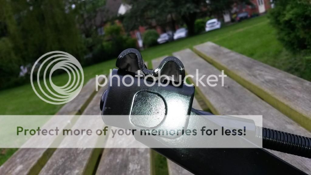

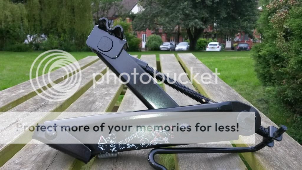

Sorry for banging on again ref jacking up points RCZ have just recieved info from peugeot warranty that they do not intend to honour their committment regard to fixing my delema.When the vehicle was purchased I was informed that the vehicle had warranty would someone please enlighten :as to what warranty stands for? Everyone tells me that I damaged my vehicle on purpose when using my jacking up points,with a jack supplied by my dealer.Would it be possible if someone takes a photo of this jack? Also my Sat Nav factory fitted does not work am informed that their is
a new version out,again this is not covered bt warranty.
My Peugeot supplied jack caused the same problem as I have previously stated. They replaced it with a different type of which I will put up a picture shortly. Not forgetting that it doesn't sound as though you are communicating with Peugeot UK ,but a third party that is supplying them with an insurance policy (warranty) In my case I was speaking directly with Peugeot UK.

It has never, nor will it ever be used. I carry my trolley jack and jacking aid for emergencies and RAC membership for all other occasions that a wheel needs changing. Never ever before have I worried about changing a damn car wheel. It is pathetic that Peugeot have created this fear, but my jacking points have been straightened far too many times now. How many times can you bend and straighten metal before fatigue causes it to fail?

This is the jack that I was originally supplied with, that caused all the damage. The replacement appears to be more suitable as it appears to me that the jacking point will sit within the groove rather than on top of it. However I am not prepared to risk it.

To clarify, the first jack supplied by Pug UK, is like the one in the link. Following the damage, they then replaced it with the one in my photos in this thread. However I have never used it, preferring my trolley jack and purpose made jacking pad.
