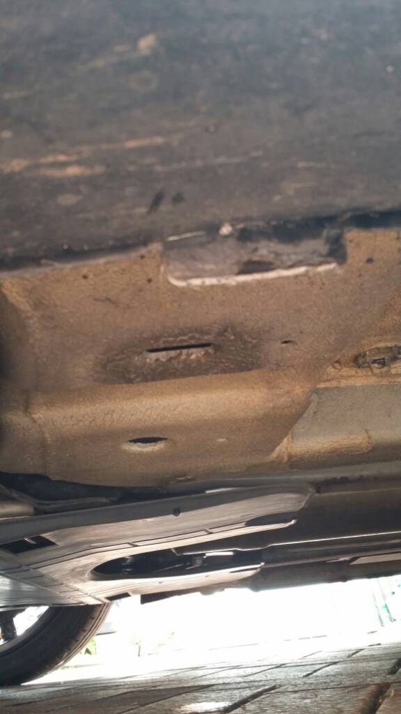

Just posted this on the rcz Facebook page.
Wherever I would jack on the front, parallel to the jacking point but towards the centre of the car there are what looks like 2 boxes. (These are structural).
Picture of passenger side in UK (left hand side)
I will use the one nearest to the jacking point for the jack, I also use a piece of wood which goes across both boxes (3" × 2" basically wide enough for the jack head to sit on but narrow enough for the axle stands to sit on), I then put an axle stand to the other box (other end of wood).
Which as the chassis is so stiff raises the rear wheel off the ground so I put another axle stand on the rear jacking point.
This is great if swapping wheels around as in front to rear.
If jacking both sides up the car will pivot on the jacking point where the axle stands are keep an eye on the rear one to make sure axle stand doesn't hit the plastic sill cover.
Use another set of stands for the other side.

52
I have lifted my car successfully on the front jacking points, but a company that took my wheels off collapsed the front offside, which they straightened but it now cannot take the weight and keeps failing.
So to stop it failing and damaging the plastic sills anymore I use the structural boxes.
Better to be safe than sorry.

Get it checked out and see where the alternative for jacking is. If you can get it on a 4 post lift.
Also jacking on the structural boxes will first lift the front wheel then jacking a bit more will also raise the rear.
Just checked under ours.......the passenger side front is partially collapsed but no damage to plastic cill, this is an 11 month old car and the only previous keeper was a Peugeot main dealer until we bought it last month. I'm guessing when i asked them to refurb the alloys prior to purchase they have knackered the jacking point.
Now given the issues I have had with them so far and the fact I have no intention of setting foot back in the place despite their offer of a free tank of fuel if I call in I have straightened it back out and treated with waxoil, I'm sure they'd deny it anyway.

Noticed after a service I have a partial collapse too to my rear offside. Annoyed with myself (after my jacking point history) for not properly seeing this.
By coincident my car was also run by the dealers manager before I got it and had previously had alloy repairs, hence previous damage.
@Jaggs - Can I ask - What did you use to get it back in place? Stilson wrench, adjustable spanner, mole grip, or something different?
