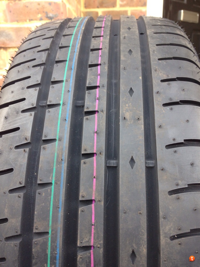

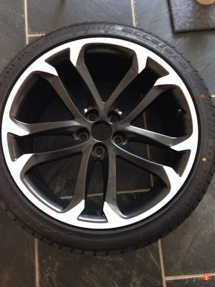

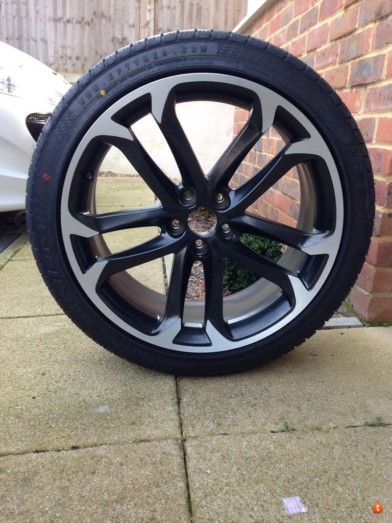

hi purchased new 19 inch alloy off ebay £150 tyre £60 and jack £30 wheel fits nice just let pressure down slightly
jimbrodie 1
Have you just put this wheel back on ebay as a new listing has the same pictures ??

Spare 19" Solstice alloy for sale, with tyre.
No kerbing - this was purchased from a Peugeot dealership and I believe is a refurbished unit.
Accelera tyre has full tread, never had to use so as new.
Will fit in the wheel recess in the boot.
Open to offers - will eBay it if nobody on the forum fancies it.
