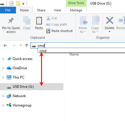

SUCCESS !!!!!!!!
Ok People I have finally been able to get past the "data damaged or incomplete" message and update the firmware.
I went from existing 2.75 -----> 2.80 --------> 2.86B (though I do not think I needed to go to 2.80 first)
The issue for me was the fact that the "System Volume Information" folder existed on the thumb-drive as suggested by sprout in this thread on the peugeot forums
I had thought I had checked that this folder was not on the thumb drive by ticking the "hidden items" box on the view option on File Explorer, however this was not enough to show the folder in File Explorer. What was needed to to uncheck the "Hide protected operating system files (recommended)" box (see below) on the "Folder Options" "View" tab accessed from the "options" box (far left) on the "view" tab of the File Explorer.
Once this box is unchecked you will be able to see the "System Volume Information" folder on the thumb-drive in file explorer.
This folder gets created every time you insert the thumb-drive into the usb slot on your PC if it does not exist.
Deleting it is a bit tricky and the only successful way I found of doing it was by following these instructions :-
When you have done this you will see in File Explorer that the "System Volume Information" folder is no longer on the thumb-drive.
Once this is done you can copy the unzipped files to the thumb-drive.
Remove the thumb-drive and do not put it back in the pc before you try it in the car as when doing so windows will automatically create the "System Volume Information" folder on the thumb-drive again.
So for me this was the process to finally get the firmware updated.
  1. Format thumb-drive of 8GB to FAT 32 with default cluster size.
  2. Delete "System Volume Information" from thumb-drive by following instructions in link above (This MUST be done before copying the files onto the drive)
  3. Copy unzipped firmware files to root folder of thumb-drive (see my previous post showing the files in the root folder, yours should look identical)
  4. Remove thumb-drive from pc (DO NOT RE-INSERT IT)
  5. Start car and wait for navigation system to boot up
  6. Insert thumb-drive into usb slot in armrest
  7. Message about checking data will be shown
  8. After a while message about doing firmware update will be shown, answer "Yes"
  9. The process to update the firmware will start
  10. During the process the screen will go blank a number of times don't panic and pull out thumb-drive leave it to continue
  11. Also during the process percentage complete messages will be displayed counting up to 100%, This happened at least twice don't panic and pull out thumb-drive when the screen goes blank afterwards or gives a message about updating just let it continue
  12. At the end of the process the system will restart and the one of the normal screens will be shown, for me it was the satnav screen probably because i was on satnav screen when I inserted thumb-drive.
  13. Once the normal screen is shown you can take out the thumb-drive and check the version.
