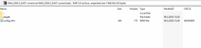

Hello NF7, great post. I've worked on one RCZ recently and stumbled on this forum. I've managed to update the FW to N42c with the files you provided. The USB with the FW update was detected but the USB with the maps wasn't. I used the 2020-2 Eastern Europe maps provided, the Navi has the original presumably never updated 2010 West maps. I'm uploading a screenshot of my USB. Am I doing something wrong, or something's up with the navi itself?

I would suggest you install the 2023-1 maps a couple of posts above is the link.
Also from the photo, it seems you are installing the risk areas not the maps. Maps have three files in the root, you have only two.

Okay, I used NG4_2020.2_EAST correct.rar which has only two files (pic provided) from the link in the first post. If I am correct the .md5 file is missing? Anyway, I will try with the 2023-1 maps, but in the meantime can I get a list of the countries included both detailed and main road maps? If Balkan is included it would be great.
I never actually made the Eastern Maps work. They were provided by another user here. I only tested the Western Maps.
This is what they cover:
Andorra, Belgium, Germany, Germany, Finland, France, Greece, Gibraltar, United Kingdom, Ireland, Italy, Croatia, Liechtenstein, Luxembourg, Monaco, Netherlands, Norway, Austria, Poland, Portugal, San Marino, Slovak Republic, Slovenia, Spain , Sweden, Switzerland, Czech Republic, Hungary, Vatican City.
Only main road coverage in the East and West: Albania, Bosnia & Herzegovina, Macedonia, Moldova, Montenegro.
