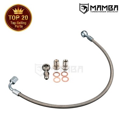

i beleive this is the one:

Thanks for that 👍 You sure this is the correct part? It's telling me on eBay it's not a match but that's nothing new 😂
Would I get it done with the car on car ramps or is a car lift 100% needed (do you know)?

Just had another look and the eBay listing states it's for an EP6CDT engine, which is my engine, so looks like this is the part alright 😁
eBay can be very hit & miss often incorrectly tagging correct parts for my RCZ 😤

Actually perhaps its not. Take a look at this one
i am sure you can get cheaper that this though

That part looks the same except it has some of the fittings already installed just leaving the banjo's to connect up.. I'm happy with the other listing you posted as it correctly specifies my engine type. Having said that I will check my reg/VIN with he eBay seller 👍

After having another look at the listings I see now the second pipe you listed has one elbow & one straight through connection whereas the first listing has two elbow connections so they are different 🙁 I'll check with the eBay seller. Knowing my luck it's the more expensive one I'll need 😤

Ok, in speaking to the supplier I have finally determined this is indeed the correct part. Part ordered :)👍
