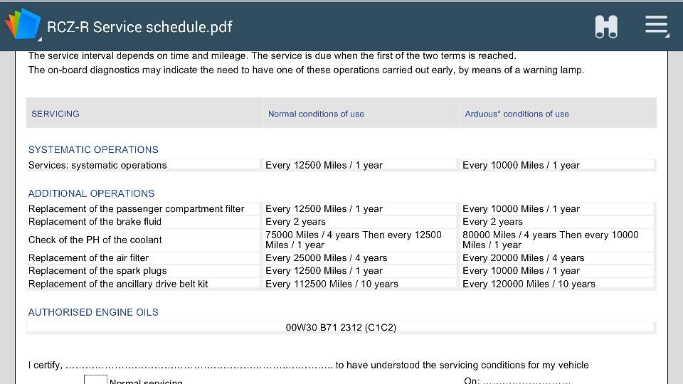

Just emailed back my nearest dealer with a screenshot of the schedule asking if is not necessary to add passenger compartment filter, brake fluid and spark plugs as recommended by Peugeot.
I´ve done 15000km since last service 15 months ago and they just quoted me for oil Ineo 0w30, oil filter and usual checks!? Price:155,56 eur
The other dealer I´ve contacted quoted me for oil, oil filter, brake fluid and spark plugs 265eur.

I´m not trying to save money, not my intention at all.
What I wanted to know is which of the two dealers were giving me the correct quotation and I´m not happy discovering that the closer one is not including important parts on their quotation, that´s why I´ve send them the pdf with the service schedule from Peugeot.
I want them to explain me why those 3 parts were not included in the quotation when they are needed.

Some of the Pug dealers even don't know about the requirement to change the gearbox oil in the RCZ R every other 12.500 miles as well (means during the yearly service).
It would seem then that even the Peugeot dealers need educating then.
In that case RCZ-R mine would need doing very soon, if you have done this procedure, what is needed ie plug washer / oil / quantity
many thanks.
many thanks.
I requested it to be done on my R at about 50.000 miles from new. So I didn't get my hands dirty. Can't tell you how much oil you need.
Back then the dealer did not want to perform this service saying, that gearbox fill is a lifetime fill. Maybe this is what they have been told by 2013 as the R came on the market. But now they know this gearbox requires frequent oil changes due to high operating temperatures and the LSD.
I cannot find anything on the yearly/12500 mile service.
This is what they are supposed to change.

tianorth said:
Pug told me they have changed it with the 308 GTi. Means, they introduced those gearbox oil changes on the 308 GTi first. Thny it should have been applied to RCZ R as well. My pug dealer didn't know about it either.
