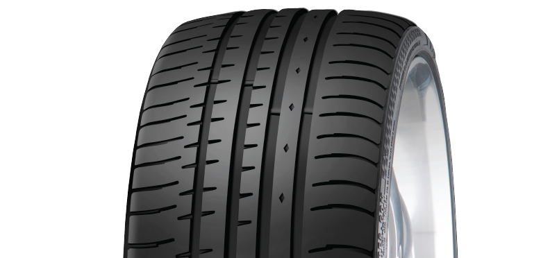

Yes premium tyres are reallly worthwhile, gives me an idea, maybe I should stick them budget tyres on the front and do burnouts so I have an excuse to buy some premium tyres šŸ˜‚
You do know the car is FWD? šŸ˜‚
3,242
746
I'm surprised to read that opinion.
Even in daily driving duties good quality tyres make a massive difference. There is a huge difference between good and bad tyres.
The tyres do meet requirements. You see the tests where modern cars slash highway code stopping distances by half. Braking efficiency and tyres have greatly improved over the years.
Looking at some of the results of the Accelera PH1 tyres the results are poor compared to a quality tyre. They are last in every test related to performance or handling.
From 100kph(62mph) in the wet Michelin PS4s take 46.3m meters to stop. The Accelera took 73.3m in the same test. 27m extra to stop which is around 6-7 car lengths. That's a crazy difference and easily the difference between stopping in an emergency, or having a big crash.
I've never scrimped on tyres. I don't see the point of buying nice cars and ruining them with cheap tyres. Equally even for normal cars the extra safety margin a good tyre makes is worth it too.
You should never have drastically different tyres on a car. It will make the handling imbalanced.
There have been quite a few tests I’ve read about the Accelera tyres some good some bad like I said I’m happy with them I’ve pushed them as much as I would want on the road in dry and wet and I’m totally happy with their performance I’ve total confidence in them if owners want to put expensive rubber on their cars that’s up to them not a problem but I don’t think people should be saying budget tyres are dangerous if they’re the right size right loading and speed rating they just can’t sell em if they’re dangerous.
It's strong to call them dangerous, but it's an unnecessary choice to reduce the ability and capabilities of your car even purely considering safety.
Car manufacturers cut corners everywhere, but none of the respectable brands fit budget tyres.
The test results for your tyres are very poor. They are miles off quality tyres for every aspect of driving expect things like noise. The braking distance differences are alarming.
It looks as if you've spent a lot of money modifying your car. I genuinely don't understand why you would spend money improving the car, then scrimping on the important parts and undoing any improvements. You've got an easy fix to vastly improve your car.
What resource are you using for that Kerr? Might be useful for us all to see how good/bad our tyre choices are šŸ˜€

Here is one Accelera test: Overall - Finishing bottom of the table in nearly every test secured the Accelera its last place, however EVO noted it wasn't as bad as some of the other budgets tested in previous years. As is the norm with budget tyres, it was capable in the dry but lacked grip, composure and safety when the surface changed to wet
Budget tyres on a sports coupe no way especially if used all year round.
Got to be Top end mid range and above if you want to actually enjoy the performance and be safe in the car.
Some of the points made on here about Budget tyres are fair enough from my experience budget are just about ok on a dry Summer road, then like the Evo test above if it then rains or in the Winter they verge on absolutely lethal in comparison to mid range and premium offerings. Literally no grip or feel, inability to accelerate or corner; it's like driving on diesel, feels like you have no proper control or feedback.
Most recent example of this is in a TF I own fitted with budget tyres from the previous owner, I thought it's ok I only do 1K miles a year in the dry Summer blasts mostly so will leave them on, yep they felt ok in the dry but broke away early and felt weird I thought ok they will do, did a journey in the wet and the abs was on braking for junctions, stepping out at the back etc. Fitted a set of Toyo's and it was night and day better the car handled, driven in the wet it gripped and the abs did not activate, on a dry road the car felt completely different and could be driven harder and corenered better.
If you toodle around Town in a family hatchback at 30mph fair enough otherwise budget tyres are a complete and utter no-no for me.
Auto Bild do a lot of group tyre tests. They are worth searching out. They also had a group test of 50 tyres and the Accelera came 49th. It was knocked out in the qualifying round for dangerous wet braking distances.
As I said I’m happy with them I’ve had no issues at all and they have performed well, to be fair I don’t do a lot of wet weather driving in my Z but I have done a few high speed motorway 200 mile runs that have been wet and again had no problems.With the results of that test looks like I’m going to be extra quick on the brakes šŸ˜‚
