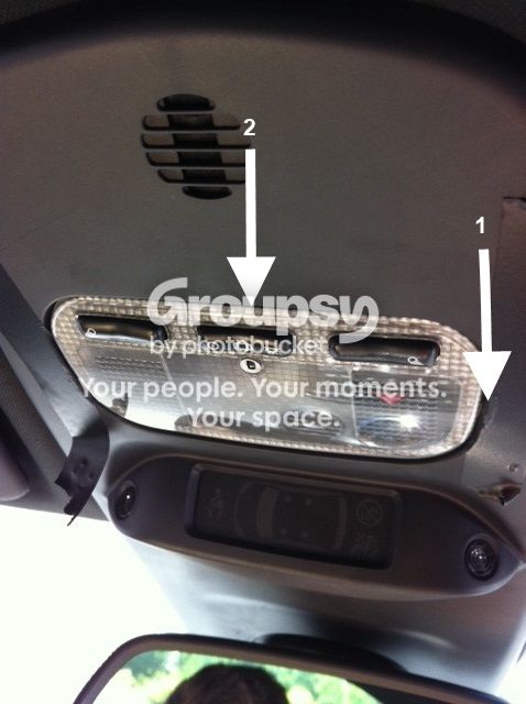

Tried to remove dome today without any success. dand87 how much pressure did you need to use and am I right in trying areas marked 1 & 2
It is tough and frustrating I know!
1 and 2 are correct. Try and pop open 1 then move onto 2. I used very small screwdrivers, ones you would get in crackers. Try either side as well and see if it works for you. You do need to be brave with the pressure, but there will obviously be a breaking point - I very nearly gave up but then it just flew open!
Are you getting any part of it to 'pop'?
Yes getting area 1 to pop with not too much force but at point 2 really put a lot of force and nothing, just got scared and stopped.
Just close your eyes and do it. It takes more force than what you would imagine. I tried the first time and failed.... then I had a strong cup of coffee and after that in a fit of caffeine rage, i managed to pop it off.
Well bit the bullet this morning, applied way more pressure than first time and the cover came off quiet easily ( :shock: Scary though).
I didn't need tape/cloth to remove bulbs just managed to get a grip with pair of pliers and out they came.
Very pleased with the results, all 10 internal and the 2 number plate bulbs now changed.
Thanks for help and advice guys :thumbup: :thumbup:

Dome/map lights plastic cover was actually very easy. I just followed the picture posted above and it popped right off :)
Footwell I was able to remove with bare hands. Glovebox light was removed with a short screwdriver.
Boot lights (the one far back to rear window was also removed with the help of a small screwdriver and the one on the side I just pulled off the side panel and replaced the bulb with the holder still in place.
Around 20min job :thumbup:
I had to change side on 2 of the bulbs before they did work but I didn't put back any of the holders in place before I saw that all was working.
