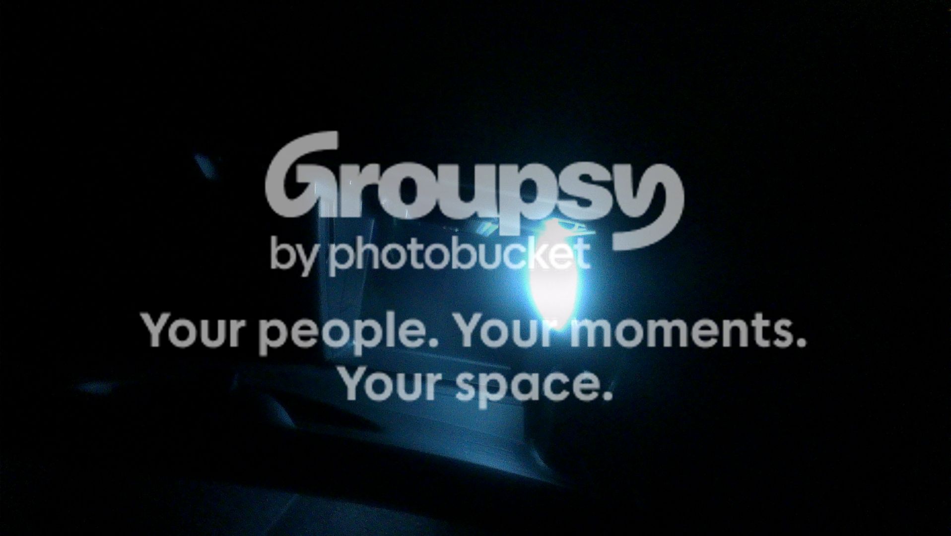

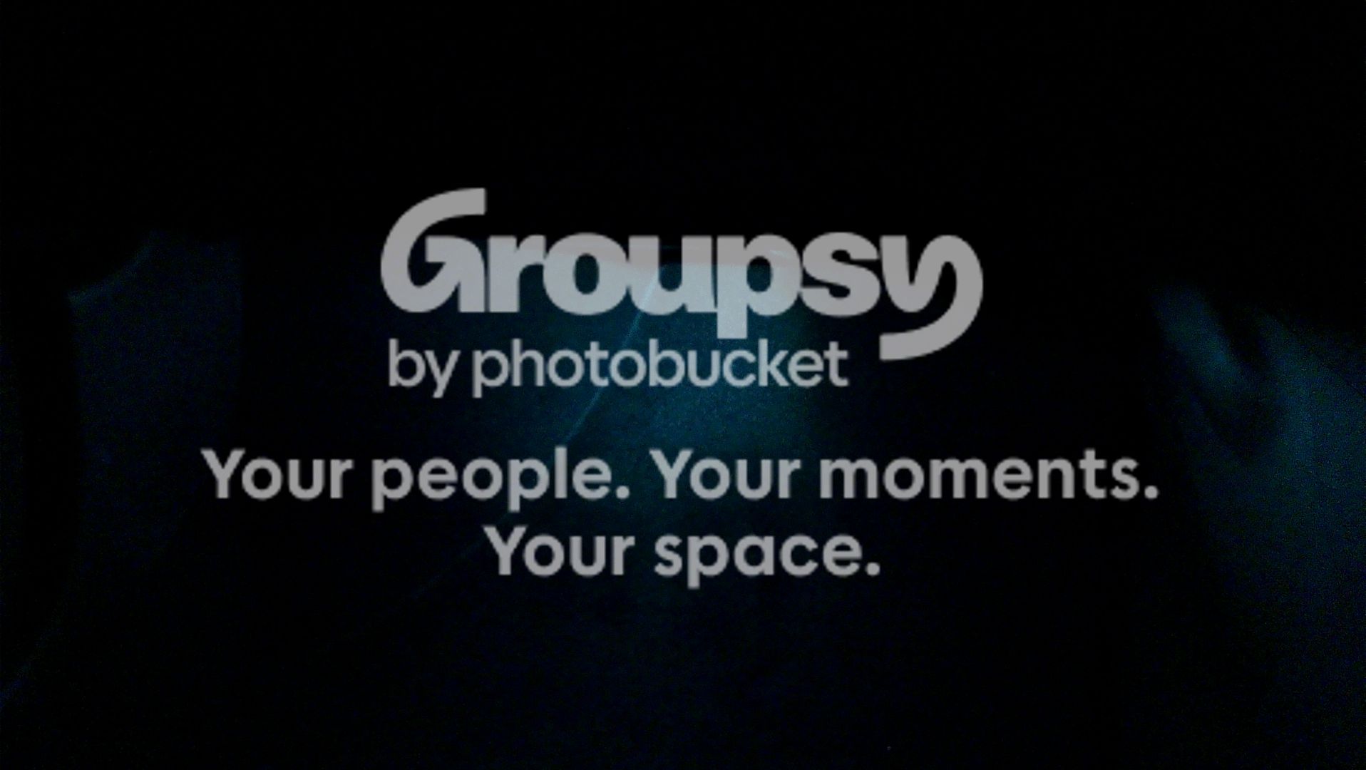

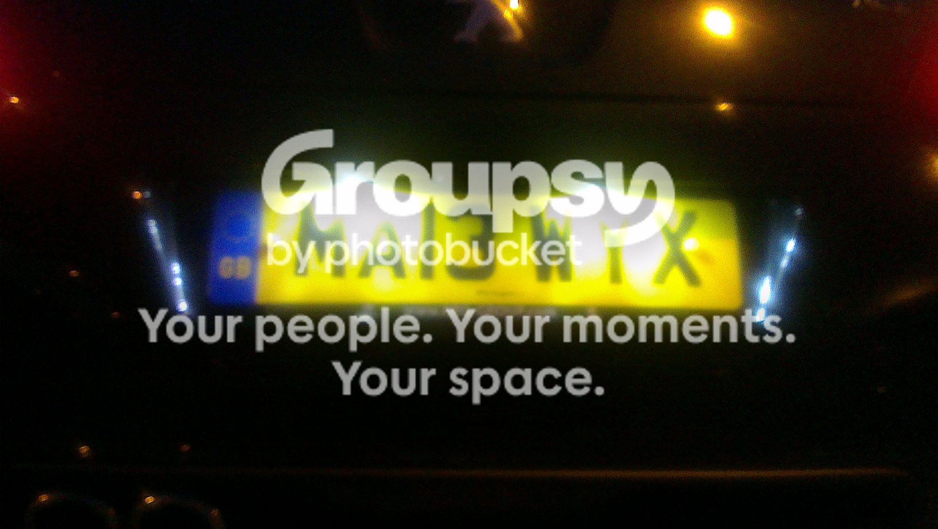

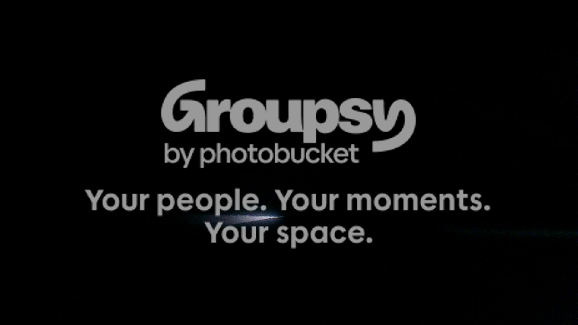

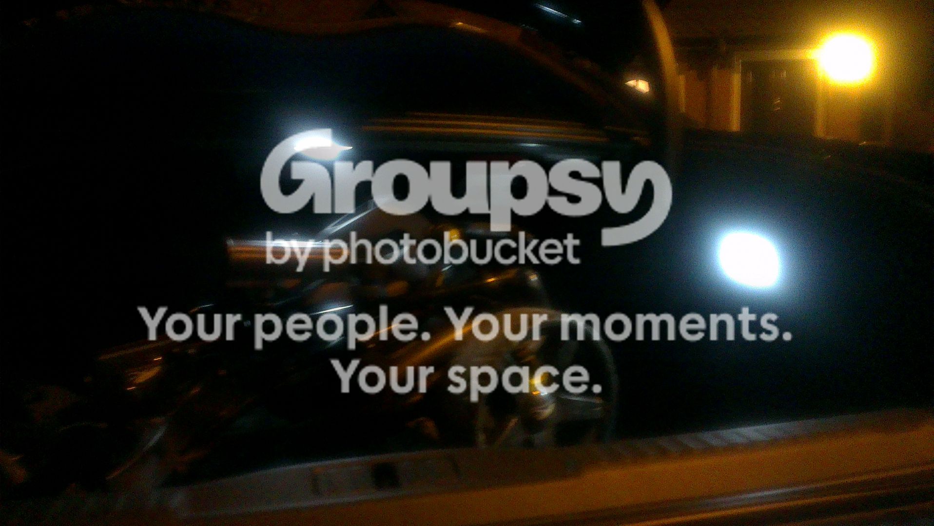

Not a massive gain I have to agree but you get the nice white light produced by LED. These pictures don't really do them justice but I'll post them anyway
Passenger Door Closed
GloveBox
Number Plate
Passenger Footwell
Drivers Footwell
Boot
