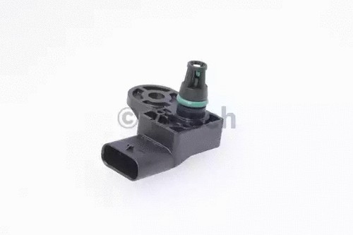

I wonder if I actually have the correct MAP Sensor for my version of RCZ (200) or are they all the same?
I have attached a picture as to what mine looks like.
But if I go to ebay and do a search it comes back with not compatible with my car:
I had to buy the Bosch one from a dealer that what is on my 200
