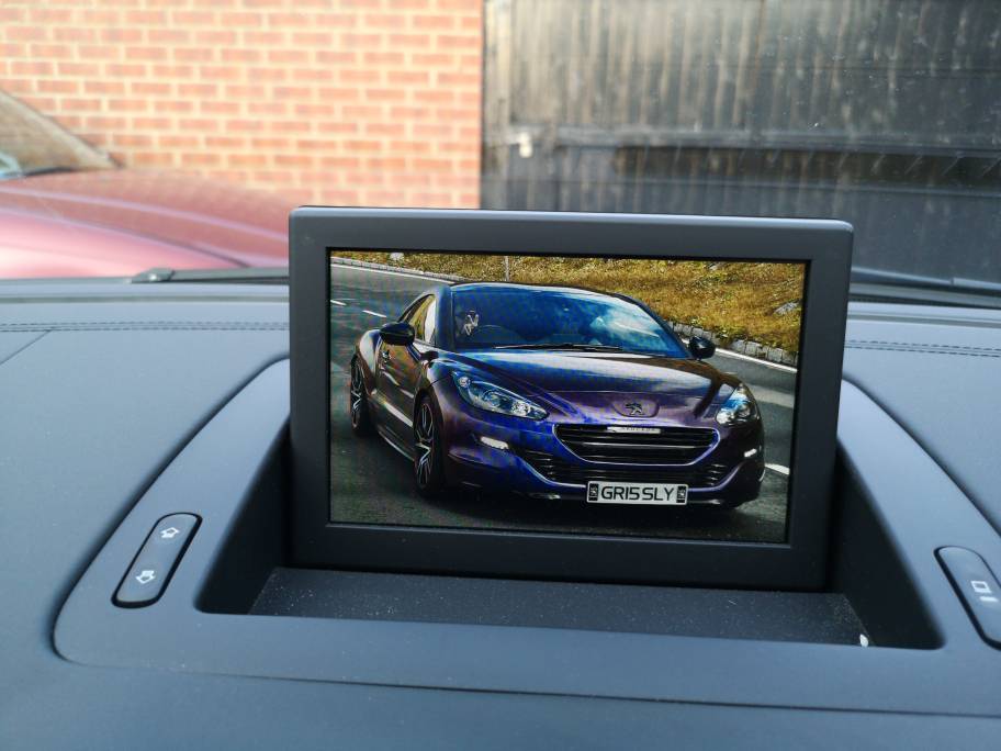

Well Pete I have done the first stage and got my picture loaded....
Not the best photograph - crappy mobile phone, but you get the jist.
Thanks for guide, now for the temp sensors, the tyre pressures already come up but only when doing the diagnostic or when flat / low.

 Hi DKZ5745
I saw this post last year and got my Moroccan Red gt200 in April. I've had a few goes at loading my "new cooler bootscreen" but had no luck. It seemed to work with no errors but just displayed a black screen.
I finally solved the problem. The jpeg was the right size. I noticed that the original bitmaps as found in the "sauveguarde" folder are 256 colour. A jpeg is 24million regardless of how many are actually used. I made a test jpeg in just black and white. See below..
It worked! So I got my desired jpeg (about 90000 colours), saved it as a 256 colour bmp, saved this bmp as a jpeg (now using 256 of 24 odd million) and followed the procedure again.
Voila! New Cooler Bootscreen! See last photo.
Thanks DKZ5745.

I thought it was about time I updated my boot screen following Pete's guide and remembering to save picture to a 256 colour BMP file and then open this picture and save as a jpg.
Easy !
