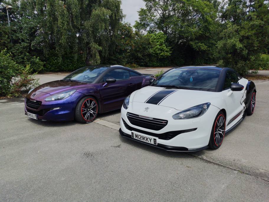

This is mine and my old car, both going to Austria next month. Can't wait.
