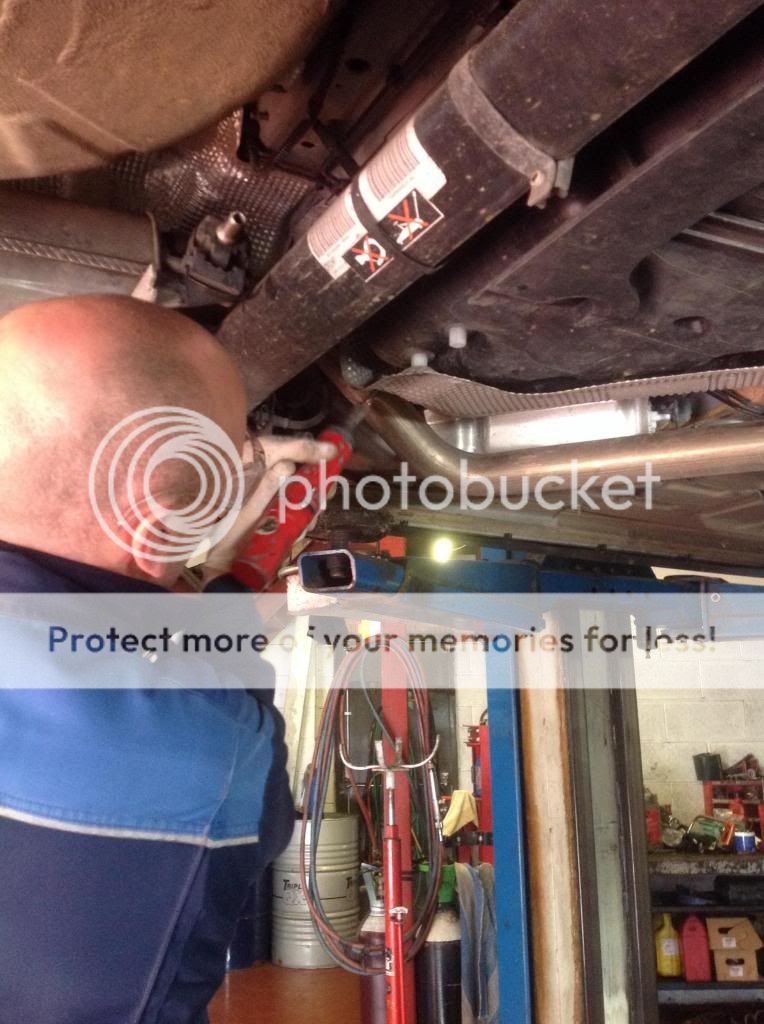

After stripping off the undercovers, light and rear valance, the exhaust is cut.
New back box is fit and connected. By mounting the clamps at 90 degrees it gives about 30mm clearance from the rear cross member. Dan the cross member doesn't actually go up and down it pivots as it contains the anti roll bar so should not contact the clamp.

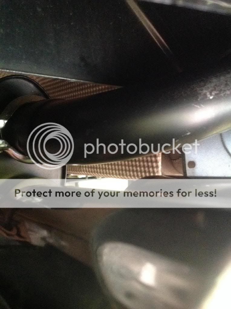

The first problem I had was, the top pipe from the rear of the back box was very close to touching the rear bulkhead just above it, only a couple of mm clearance. So I had to fit a couple of spacers to create the gap seen in this picture
Spacers fitted on exhaust hanger

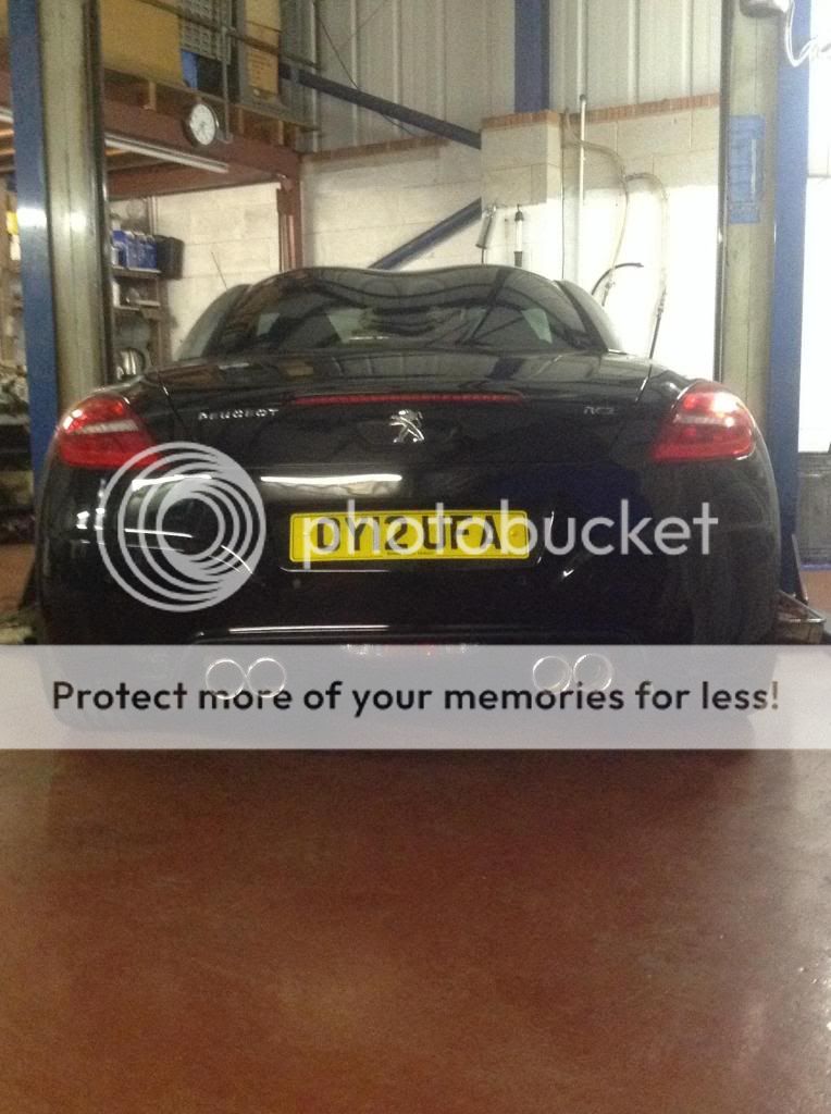

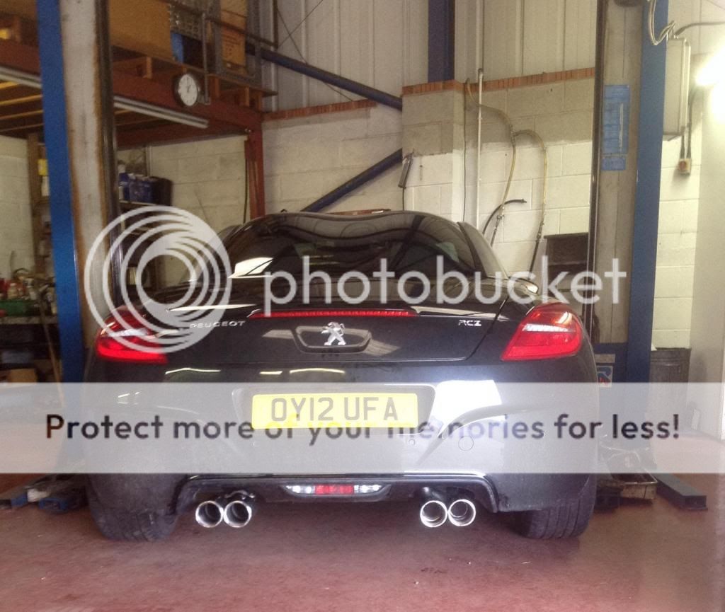

So after cutting the new opening in the valance with the template and a jig saw, putting it all back together and a bit of a wash this morning this is the result .....
All in all I'm pleased with the end result. However the tail pipes are a fair bit lower than the originals. This can not be helped as the position is set by the hanger position on the new exit pipe (RHS) and the LHS has to be set to match it. The RHS tail pipes (chrome outlet) are much shorter than the LHS which they have to be due to the short gap and bend in the cross pipe. This means you can see the pipe work behind the chrome trims from behind the car on both sides but is worst on the RHS. This could be improved by not having such a large cut out in the valance. If I did it again I would probably cut it about 3 inches lower. Yes it wouldn't match the LHS but would be better than seeing the pipes. See below ....

Looking good Jim but yes it is too low.
If you spend a little time adjusting and maybe trimming here and there you will be able to raise the exhaust and the tips will be higher and closer to the factory rear valance because it is too low at the moment as you have mentioned and shown in the photos.
Each RCZ seems to be a little different and so additional trimming and adjusting is required.

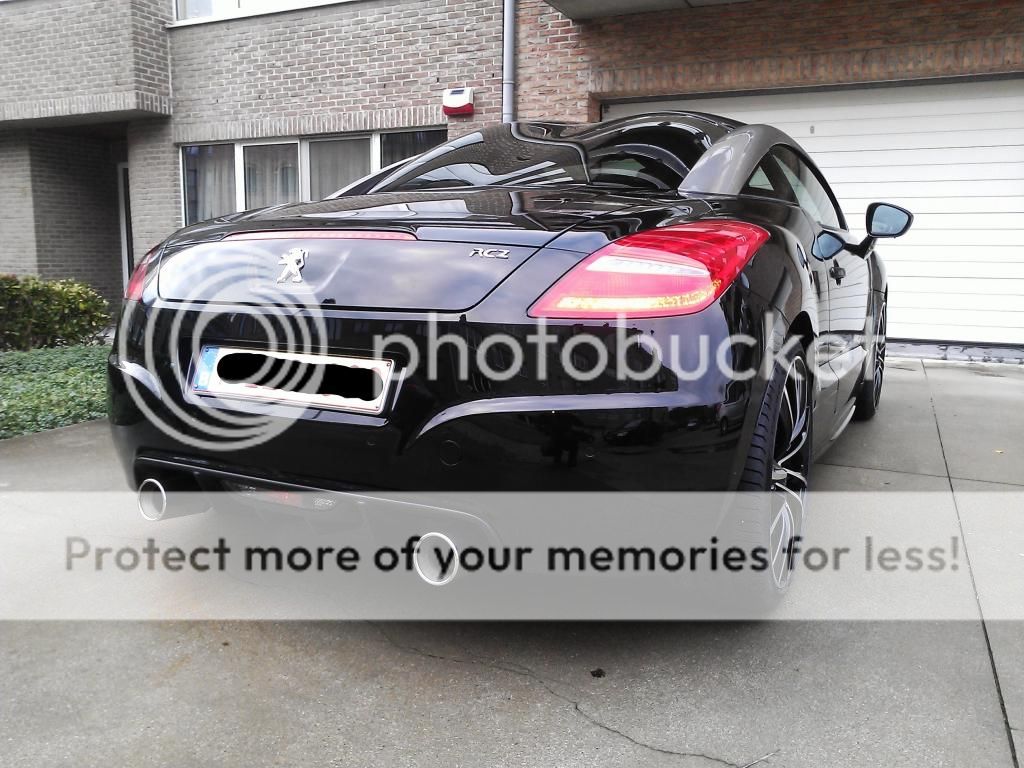

I had my complete exhaust installed by Rüffer in Germany and I stayed in the work shop while they where mounting it.
I was surprised it took a lot of time to just position everything just wright, but at the end the result was more the ok for me.
Tip : After the finished the mounting and I was satified with the result they spot welded al the parts
This was the result

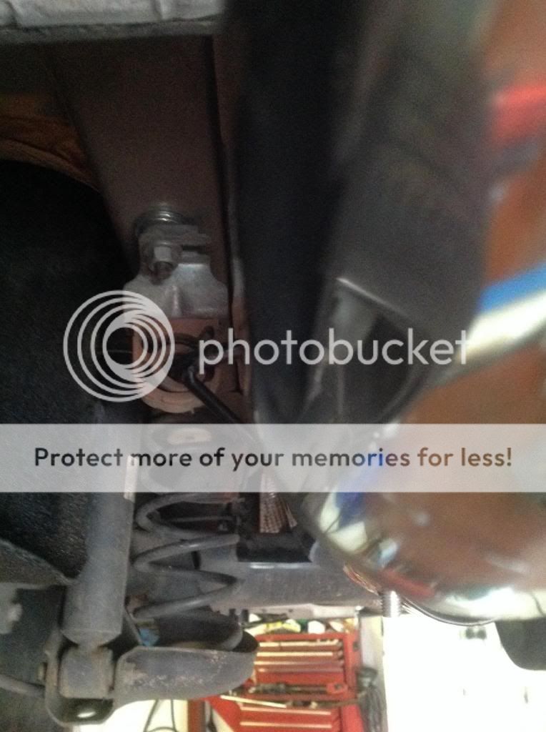

The problem is the RHS tail pipe connects to the cross pipe at a 45 degree angle, so it can be twisted to the right which raises the trim but points it outwards or to the left which points it down and inwards. There is only one position where it points level and directly backwards. The height is then set by the hanger which has no vertical adjustment.
We did consider cutting the rear bulkhead as shown in picture 4 to allow us to raise the whole back box and keep it sitting square however as this is a metal plate and part of the rear structure I didn't want to do that. The other option was the heat up and put a flat spot in the top pipe to allow clearance but again I thought this may just accelerate the metal fatigue that all exhaust suffer from.
