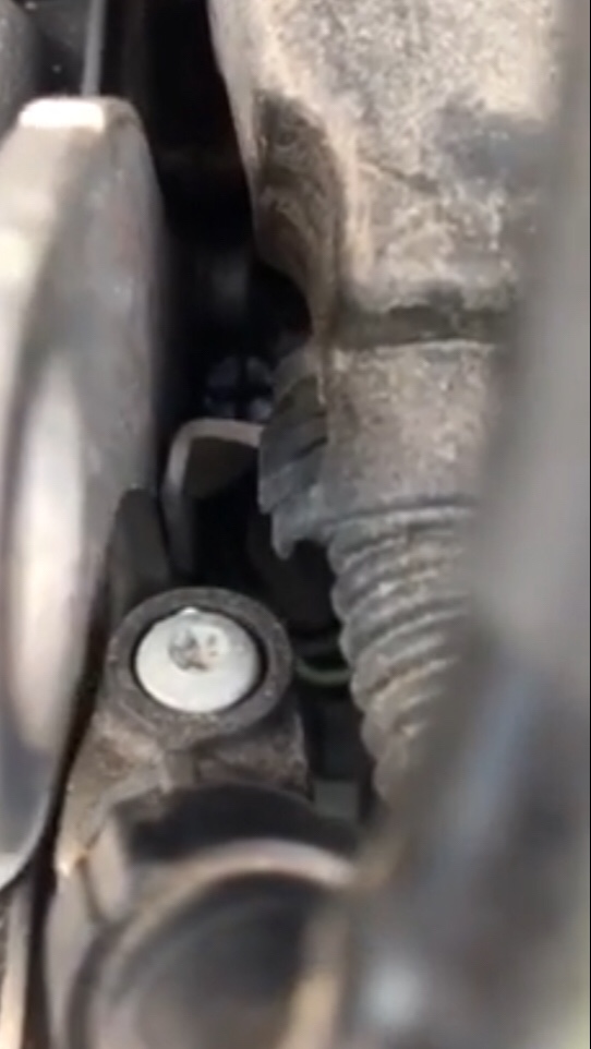

It’s on top of the thermostat housing a black plastic cross cut head screw you don’t have to turn it far to release air/coolant so whatever you do don’t just unscrew it!
It’s on the right hand side of the engine block
Zoom in on photo it’s in the centre
Yeah found it seemed to help didn’t get the time to do it properly will do it tomorrow and let you know, anymore advice will help tho guys
