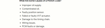

Yo folks !!
After a long time with zero issues 5 days ago p000a error popped. Checked , and then changed the relative sensor with a new NGK.
Today popped this morning , with car a little bit still cold. If clear it car goes perfectly .98k km's , do you guys think that the time to do distribution is finally arrived and these are first signals of that ?
2,602
815
This code amazingly means nothing but that is not entirely true it can be triggered by software bugs or numerous Mech or Elec issues & you could be spot on with the timing chain being stretched to the max but to get 98K when the timeline lifespan is around 100.000 Klm is pretty good going & shows how the engine has been properly serviced
