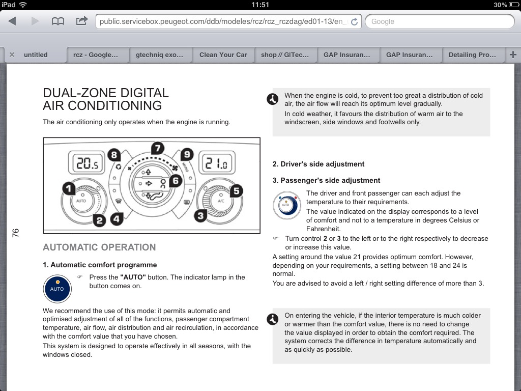

Steve, it works like climate control if you have Auto button on and A/C button on together. Keeps an ambient temperature to whatever you have set. Taken from the manual:
