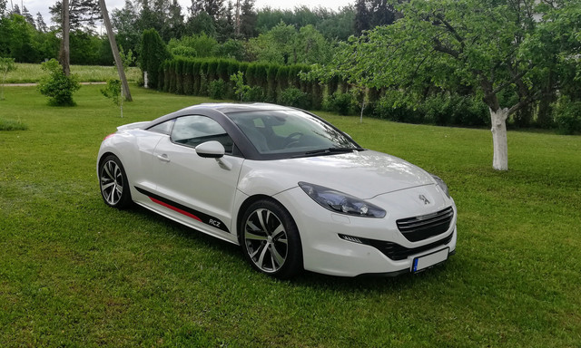

Hello,
finally i got my RCZ! It is MK2 2013 200 GT pearl white with black arches - exactly what i was looking for.
I did 200km and so far this car is pretty fun to drive :dance: I really like the interior. Seats look great in black and white. Today i will have a fun time washing it and exploring all the buttons and features. In my to-do list i have Pipercross air filter and RCZ R gear knob (i don't like the original gear knob as it is to round for me).
I hope to get some help (if needed) in this forum since i'm not a car guy :)

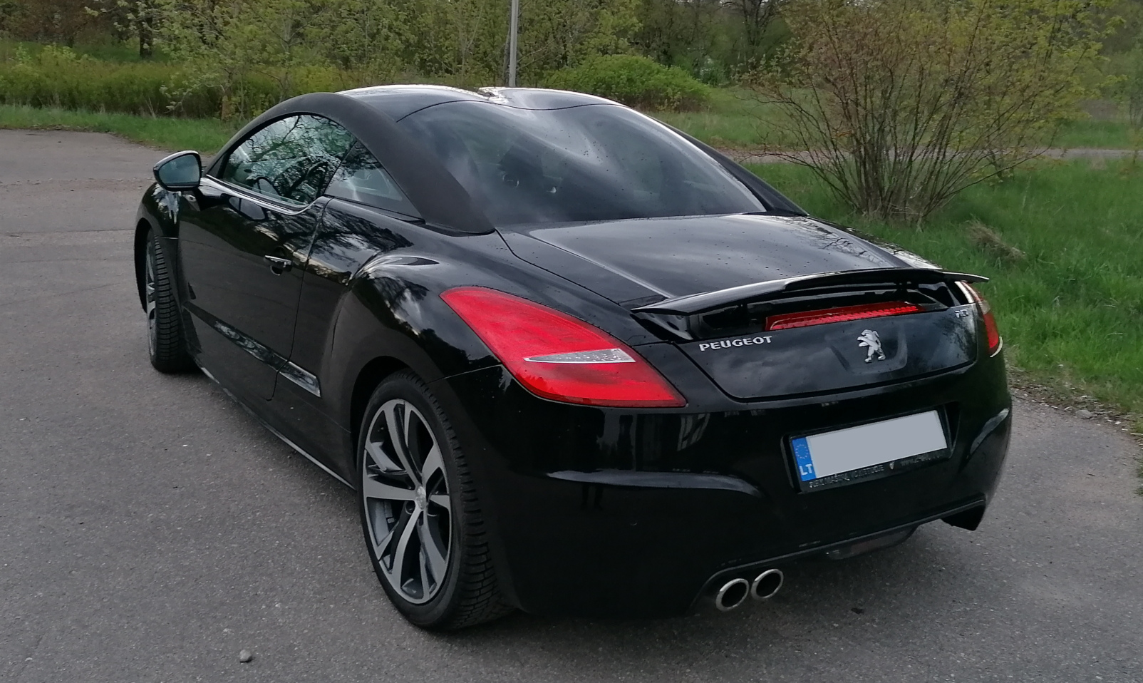

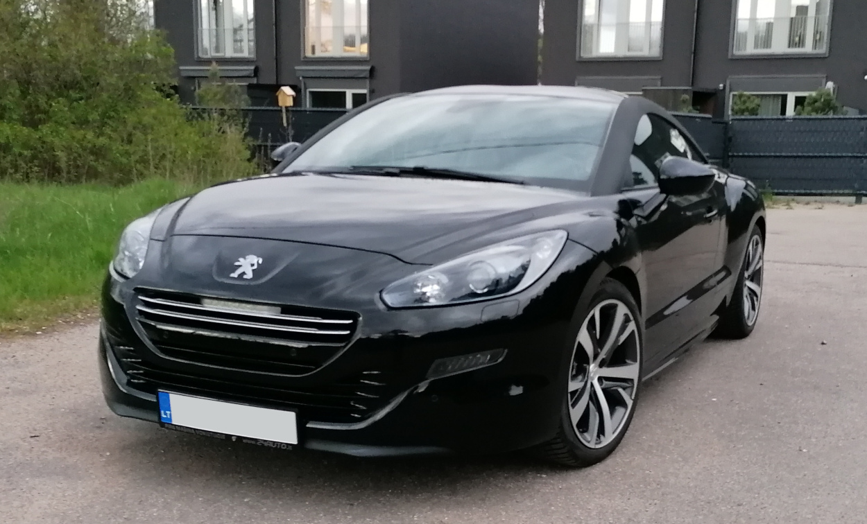

A few months ago I got into an accident and my old RCZ was wrecked.
I decided to get another RCZ. This time a black 200 THP.
I got it relatively cheap so I knew there might be some engine-related problems and today P0012 (camshaft timing is over-retarded) error showed up. Other than that, the car runs fine 🥳
