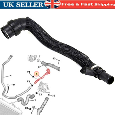

Water pump to radiator pipe after some timing chain jobs can get misaligned such that it rubs on the driveshaft. Yours has had this issue and has been bodged with a bit of pipe and jubilee clips but the oil leak has soaked into the rubber and turned it to soft goo. Edge of your red circle.

here’s a link to the bodged pipe, other suppliers do them too, if you change it make sure and position so it’s not rubbing on the driveshaft.
