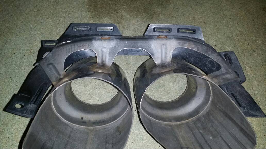

A few pics of mine when I removed it to put quads on.

I've had mine off, easy enough job.
I'm a seasoned fiddler though :D

Seriously - I'm no master technician (by a long way) but it wasn't a massive ballache for me... no more than 15 minutes if that... I think that chap on the video was building up his part a little!
Cleaning in situ will drive you mad.
It's a few screws, a few clips and a few tugs (so to speak).
Give it a whirl.

I had a go at removing them and had a good and bad experience.
The good
The 3 X T27 bolts are easy, the 2 X plastic clips are a pain but not terrible to remove (especially with a spudger/mobile phone repair kit).
Removing the diffuser was quite tricky where it is close to the tips. It almost felt like there was a screw or clip still there, and I was sure something would break. However, I finally removed the diffuser (don't forget to unclip the wiring connection to the lights). which allowed the tips to slide forward away from their clips, and out.
I cleaned with wire wool, autosol, and a buffing wheel on a dremel. Slight pitting on the underneath, but almost as good as new.
The bad
I cannot for the life of me get the diffuser to go back home properly. The problem I have is that the platic bodywork above the diffuser is very flexible, so when you apply pressure to fit the clips in, it just bows forward.
The annoying thing is that the diffuser covers the area you need access to to stop it bowing forward. :evil:
Here you can see the clips not engaging.
The other problem was the light cover clip has snapped off in one corner with all the wrestling so it now droops.
Well at least the tips are shiny!
