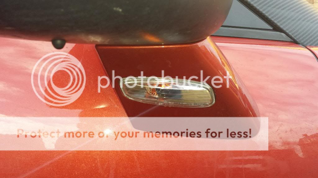

Peugeot in their infinite wisdom have made the side repeaters a closed unit. Meaning, that if a bulb goes, you have to replace the whole thing instead of just the bulb.
Fortunately, this is easy to do yourself.
I replaced mine with black ones, but its the same for a direct replacement.

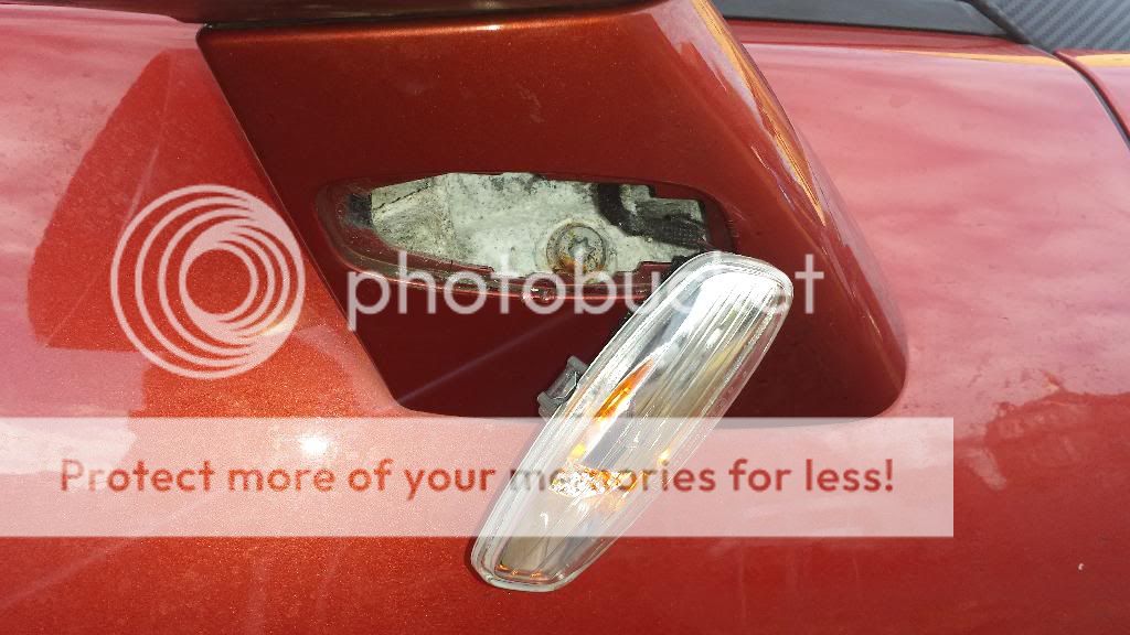

Step one:
Unclip the side repeater.
It has a metal clip at the top and bottom of the unit. The easiest way I have found is to pry it out from the bottom using a small flt head screwdriver and once the bottom is free, you can pull it out with your hands.

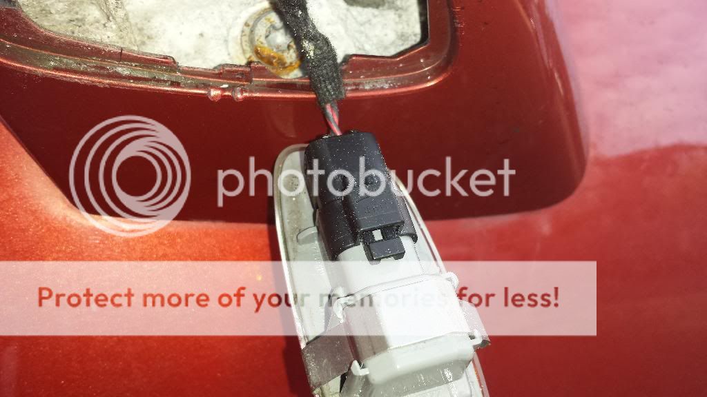

Unplug it.
Its just an easy black plug. Remove this and the unit is free.

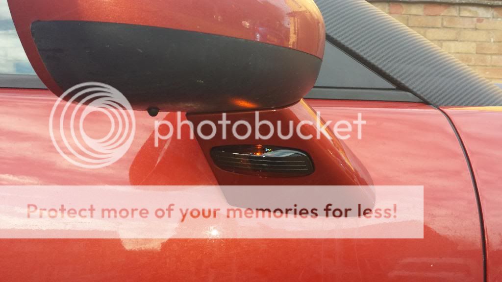

Plug in the new unit and then push back into place.
All done.

Personally I wouldn’t use a screwdriver like that it’s a sure way to damage the paintwork a plastic trim removal tool would be better.
