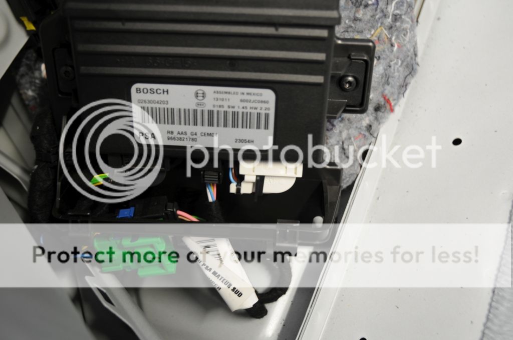

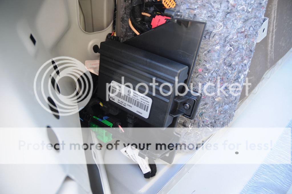

As some have said here, the sensor ecu is in the boot on the l/h side near rear light. It can be reached through the little door in the boot paneling, but I took the whole paneling off. The chrome D ring was held on with a torx screw behind a plastic cover.
This is the ecu for front and back ( 8 sensors )
This is the rear only ecu ( 4 sensors )
In the rear only the spare connector is in the loom ( here in white )
rear only ecu ( no connector on right )
front and rear ecu with extra white connection
part number of f+r ecu

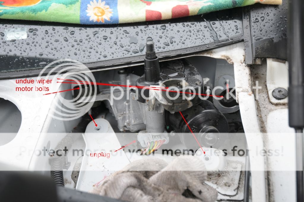

wiper motor on r/h side needs removing and it's a bitch.
needed to remove wiper arm from motor - this was the bitch bit.
once wiper motor removed its easy access to the rubber grommet for entry through firewall

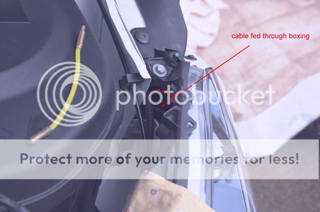

cable enters somewhere here - you can't see exactly
this is what happens if you try pull from the first indent, make sure to connect to the very bottom of the arm

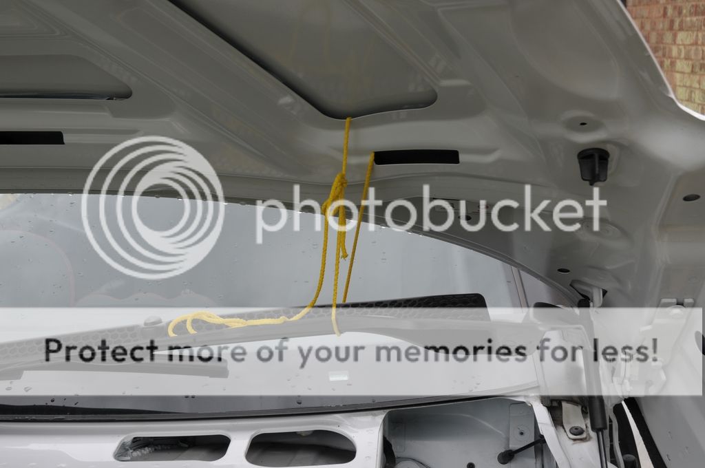

getting the cable through
and eventually

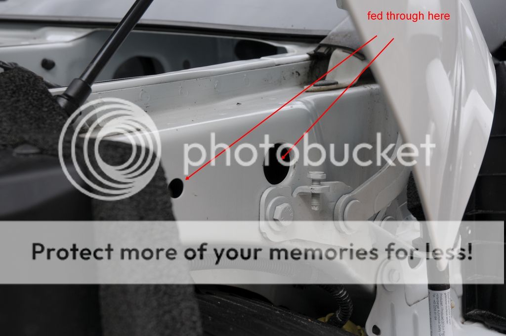

getting the cables through is not easy, it feels as is something is stopping it - it is - the soundproofing and firewall, gently push with some steady controlled force and you should be ok
cables in the car - yeah

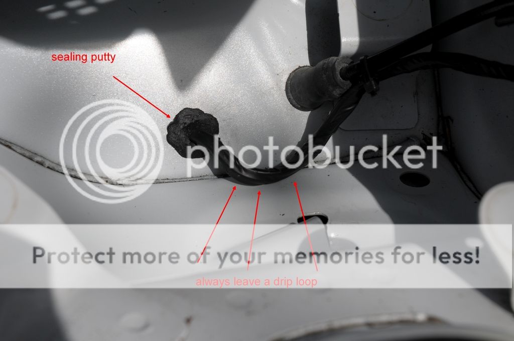

Make sure to put a drip loop to stop the water flowing down the cable and into car, the loop collects the water and it drips here instead. Always seal the hole to further stop the ingress of water into the cab

The new car was easier because I only needed to plug the connectors in, and didn't need to run cabling etc. But these only worked with audio not visual, as mentioned previously - the BSI AND the audio head system needed programming so that the sensors was displaying on the screen and giving an audio indication as well. ( I think only the BSI needed doing but as I was not present I cannot say for sure - this is what he told me he did ) this bit I had to succumb to the Peugeot garage because I did not have access to the PP2000 system needed to reprogramme. Incidentally the garage ( Peter Ambrose - Castleford ) charged £72 for this work, so my full cost to do the two bumpers and sensors swap over was - £140. If you wanted to do the same but only had the one car and therefore had to get a front end from the scrapyard etc which had the factory sensors in, you would just need to change the parking sensor in the boot for a F/R ECU and Peugeot quoted me £220 for this, then any additional painting required.
The point is though - it CAN be done with only the additional ECU and a bit of programming.

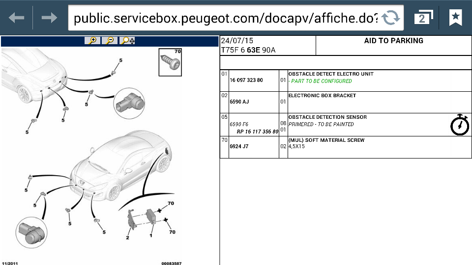

If you were fitting factory fitted sensors from another car - it is easy. The control box for both front and rear sensors is located in the boot. If it only has rear sensors then the ECU in the boot does not have the white connector on it, but the wiring has the connector behind the box. All you need to do is unplug the old ecu and plug the new one in which has the white connector ( this ECU is for front and rear sensors ). The actual sensors fitted in the front bumper, connect to the wiring harness which feeds your r/h side daylight running light and the motor for the headlight washers if fitted, and it sits attached to the bumper with a dummy plug on to stop water ingress. After that you will need to reprogramme the BSI / audio system for the displaying of the front sensors.
You do not need to run any cables anywhere, they are already in the harness not connected. Always check first before buying another front bumper or the sensors from another Z.
