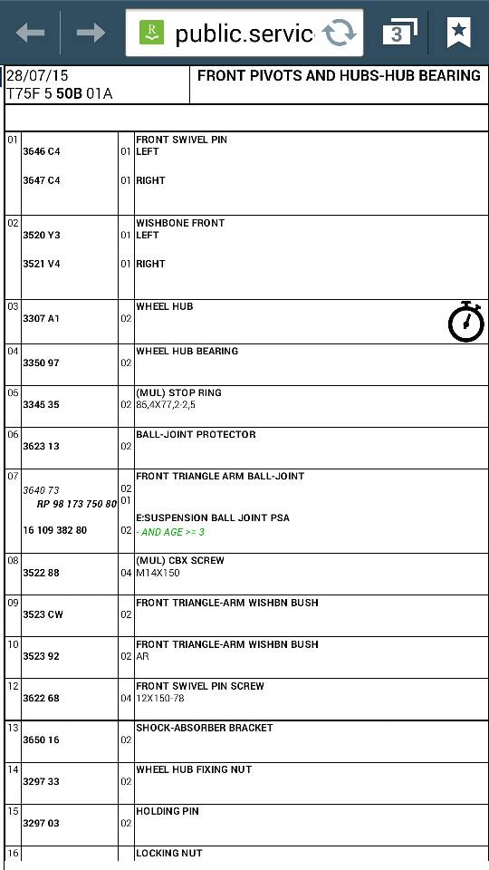

As for the wheel hubs according to tianorths post they are the same
Or do i miss anything? Same code same size
But if this is correct Then why brembo and other manufacturers have different brake kits for 156 and 200?

after a visit to a dealer and compairing the codes from mine and another rcz with the big brakes, we found out that 3 and A from the diagram above are different
no plug and play brakes for me
3 is called wheel hub
How do you describe A?
