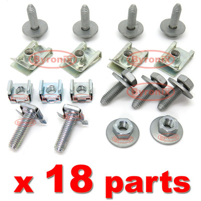

Thanks - this is very helpful! Appreciated. I did see a “half-tray” on Amazon ie not as long as the HDI one.
2,845
874
Just did oil change on my 200 this morning it does have a "Sump cover" but gearbox side is open the wheel arch on the nearside is clamped to the bumper undertray with large plastic grommets pushed into both holes to secure them I bought 3 boxed sets off amazon which has the perfect sizes as they need to be quite long to reach through both panels

If it’s of any use, my Rcz came with the half tray underneath and as I wanted to keep the underside of the engine clean after detailing it I bought a full tray of eBay (brand new aftermarket, fits okay) and a fitting kit. Wasn’t dear, think about £40 + £10 for the kit. I will look up the details when I get back from work tomorrow. Just one point of note, I bought it as a pug 308 to get the full tray, and yes it fits in all the right places as underneath they are the same. Before I bought it I checked by taking the one of my 308 and trying it. Also I have not overheating issues etc after fitting, just a cleaner engine bay.
