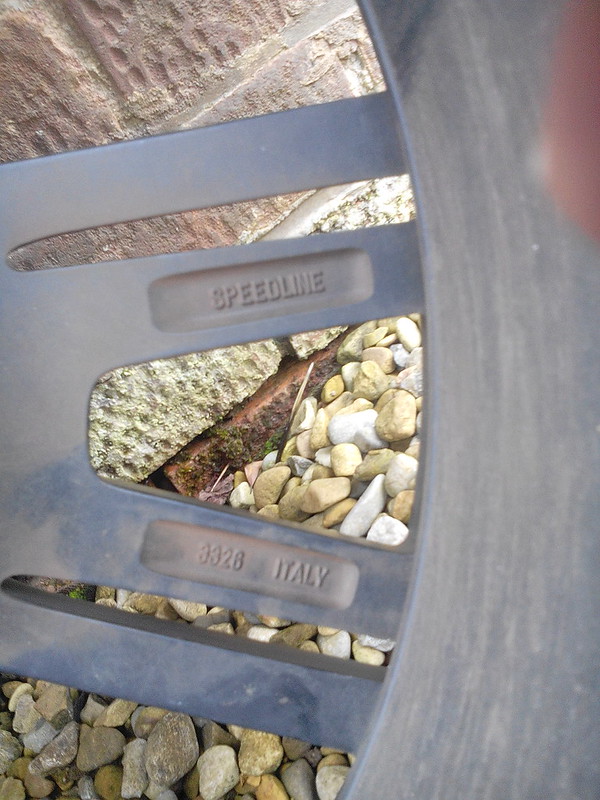

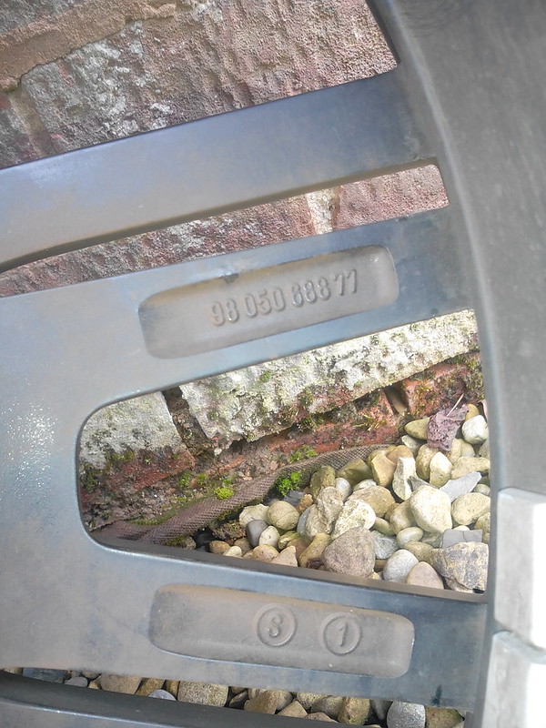

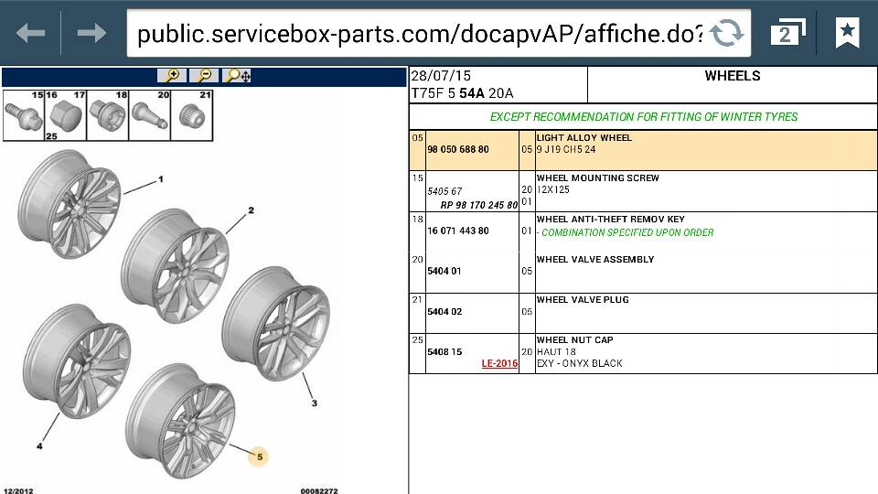

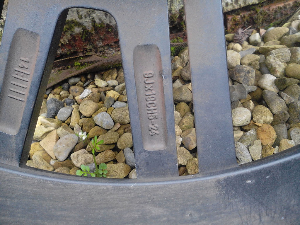

Thanks heaps mate. It should have some letters stamped onto the back of the spokes.
It'd be something like '19x9' and should have another stamp with 'ET27' etc which would be the offset. Other stamps will likely include place of manufacture, maximum weight etc.
SilverGTi_6
Mar 6, 2017
207
If it's easier to just take a pic of the writing / letters that'd be awesome.
Really appreciate you doing that mate. Forgot that you had an R!
Here you go...
the top pic is what your after, hope it helps.. :thumbup:
:beer: M.

@plecodoras
You did what I was not able to do on a Sunday :clap:
