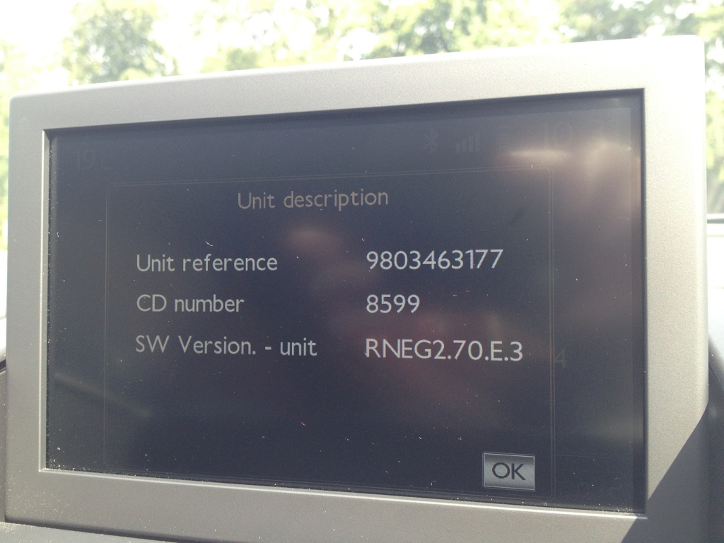

Interesting. Do you know what build of firmware your system has? I'll see if I can check into mine and we can do a comparison.
The only info I could find was the following
United_kingdom Navteq 2012/13
Don't know if it means anything to you?

Thanks, RCZ1 - reckon it's the last line I'm interested in.
However, tell me how you found it, please - 'cos I haven't yet succeeded.

Well, after a short visit to my dealer and a small firmware update I am now inundated with TMS messages.
All is well.
