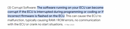

Did we find out where he got the ECU cloned and how he did it a d what it cost. I have all the same issues. Desperate to get the car fixed. I can't scrap a decent rcz. No one can find the issues. I need ECU ideas. Already had the ECU check came back with no faults. But I don't believe it. Any one got any ideas to help pls.
2,906
895
Software could be corrupted as they can corrupt themselves like when I found this issues on this car a 207 cc had to get the ECU reprogrammed after it was fooked up by some idiot
