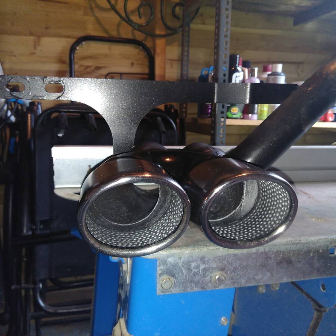

I reckon the banging my car has been making was the back box knocking inside the quad tailpipe finisher.. thing..
So I took it off to look, and decided to give it a spruce up and de-rust the mounting bolts plus gave the black parts a coat of satin black.. They still have some pitting on the stainless end piece, but look a lot better :)
Fyi, acid wheel cleaner is a brilliant rust remover.
:thumbup: :thumbup:
I need to have a go at my duals, they are a bit black lol
When I made my quads, I had to cut off about 1-2" from the tail pipes coming out of the back box.
On these pieces was a wire wool type material, which I chiseled off and then put around the shortened pipes and then into the quad diverter box.
Not heard it rattle at all.
1,297
I used a piece of glass fire rope that I had left over from our log burner door seal.
So far, no knocking.
