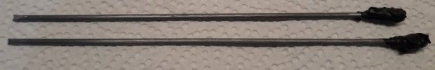

Just replaced the bigger model with the smaller one. On Youtube, there are already many videos but I saw many people damaging the steering wheel making big holes for a flat screwdriver just to push the metal spring and release the airbag.
These are the "special tools" I created using a welding electrode
I was able to push the spring without making big holes on the sides of the steering wheel. In the end, I used just one tool, first on one side and after on the other one.
