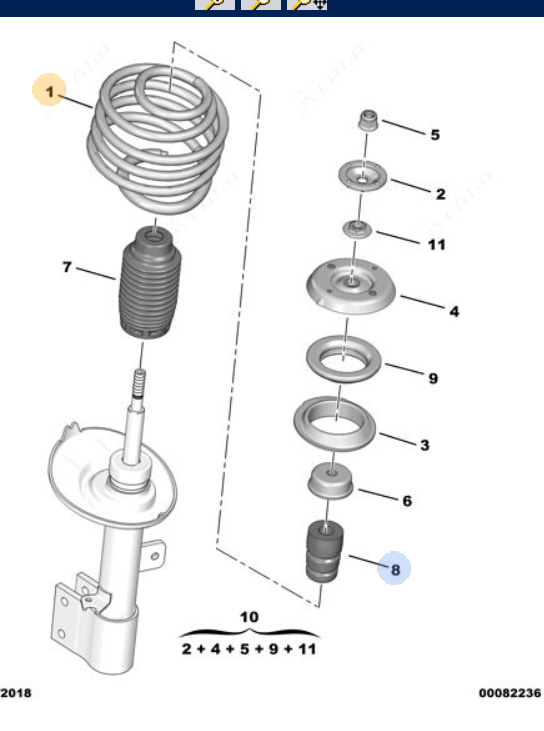

I've got a broken spring front right. There is also play in the track rod end.
Anyone got part numbers or best place to buy?
Thanks in advance.

I asked fish brothers about the spring. They sent me a link to a spring that is listed for the 2009-2015 Peugeot RCZ.
Isn't the R different shocks and springs?
Kerr
Oct 19, 2019
799
229
The number is was given for the springs from a couple of people was
98 074 727 80
Finger crossed they are the right springs.

It was the right springs. I should have confirmed that for future reference.
£140 each is excessive. Eibach do a full set of four for £150.

Anyone know how to get a genuine peugeot RCZ-R NSF Spring as my dealership has it on back order for the last 3 weeks & its an MOT failure if I dont get it fixed ASAP. :) Part ref 980747280
Kerr
Oct 19, 2019
799
229
They are on back order at Peugeot Parts Direct(Fish Brothers top)
Have you tried phoning around a few dealers? You might be lucky that one might have springs in stock, but dealers don't carry much stock.
It's also good practice to change both springs at the same time.
I remember when I changed my spring the cost of one Peugeot spring was the same as a set of four aftermarket springs from Eibach..
2,838
874
My 200 failed the MOT on a broken spring OSF so changed both & the complete top mount assembly as these are a known issue better to do it sooner rather than strip the lot off later & the difference in handling was instantly evident on cornering etc
