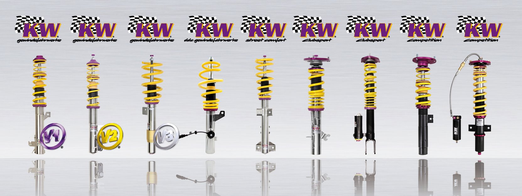

Custom made KW Competition coilovers feature independent rebound and compression damping.
https://www.kwsuspensions.net/products/competition

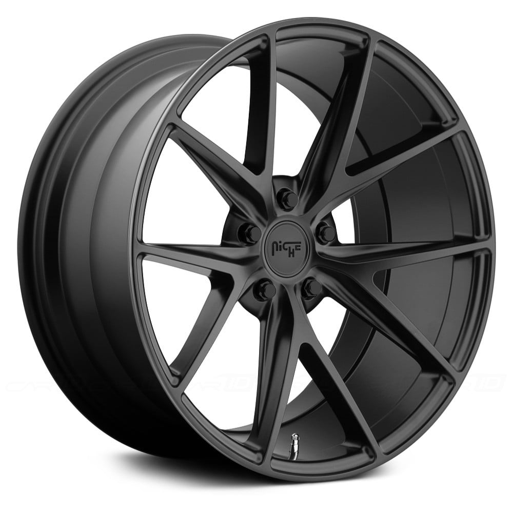

Niche Misano alloys in matt black
Front 9x20 with Michelin Pilot Sport 4S (235/35)
Rear 10x20 with Michelin Pilot Sport 4S (275/30)

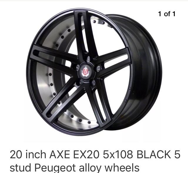

Looking forward to hearing what you think about the coilovers I've been looking at the same setup been looking at alloys but as yet only seen these that maybe will look good on my Z

The coilovers I ordered are custom and hand made by the Racing Division of KW :thumbup:
Before the mount they will mount them they will weight my car on all 4 wheels, so the can see the exact weight distribution over the four wheels. Then they mount them and put the car on the scale again to see the new weight distribution.
First of all they will set up the suspension to got same distribution of the front and the rear wheels as original.
Then because a car never way the same on the left and the right side they will in a second stage fine tune the suspension to get as close as possible an even weight distribution between the left side and the right side of the car.
After this the car will not only be Lowered but no the weight distribution will be close the perfect. Together with much stiffer coilovers I think I will really be able to feel the difference. The only un-balance will be in bank account :lol:

Personally going coilovers doesn't always mean firmer, the biggest benefit is being able to control the bump and rebound, I. E. How it assorbs bumps. You can have the car the same firmness spring wise but have much much better control over the bumps.

But with most of the "standard" coilovers like KW V1, V2 and Bilstein B14 I would get the look but it would be less good suspension compared to the original R suspension. So with the KW Competition I have the look and I upgrade the suspension quality (even if its a lttle).
So with the KW Competition I get the total package.
