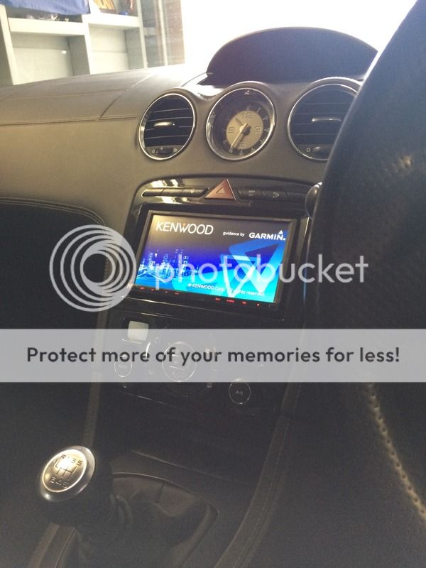

SilverGTi_6
Mar 6, 2017
202
You can still achieve a relatively OEM look with an aftermarket double din sat nav system. They generally contain a much better nav that the peugeot system as said above also.
Not the best pic, but you get the idea.
