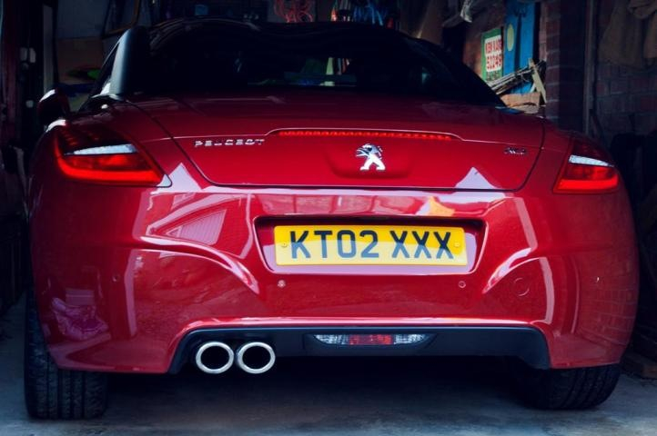

RCZ1 has answered many of your other questions but, having the original feline kit exhaust (as manufactured by Zunsports as RCZ1 points out and available through RCZperormance's online shop). I have found that it produces a subtle change to your engine note but nothing akin to the throatier noise that a performance exhaust system such as Bastuck, Ruffer systems etc will produce (also available through the aforementioned sponsor's shop). I wouldn't really say that the exhaust is squared however. I can't honestly now recall what the original exhaust was shaped like and perhaps these are slightly more oblong shaped? The pic is from my own RCZ with feline exhaust prior to changing the reg plate.
They are rather more circular aren't they?! Couldn't really recall them in all honesty.
I'd echo the comment above re the paintwork. Wow... :eek:

I need sunglasses on when looking at that paintwork...
Yes Rizz's car is gleaming aint it :lol: :lol:
Oh, so is yours RCZ 1 :D :D
Cheeky ;)
Mr Rizz's backend does look sparkling too :thumbup: he must have given it a good clean ;)
:lol: :lol: :lol: :lol: I'm proud to announce that I am almost fully house trained too. ;)
