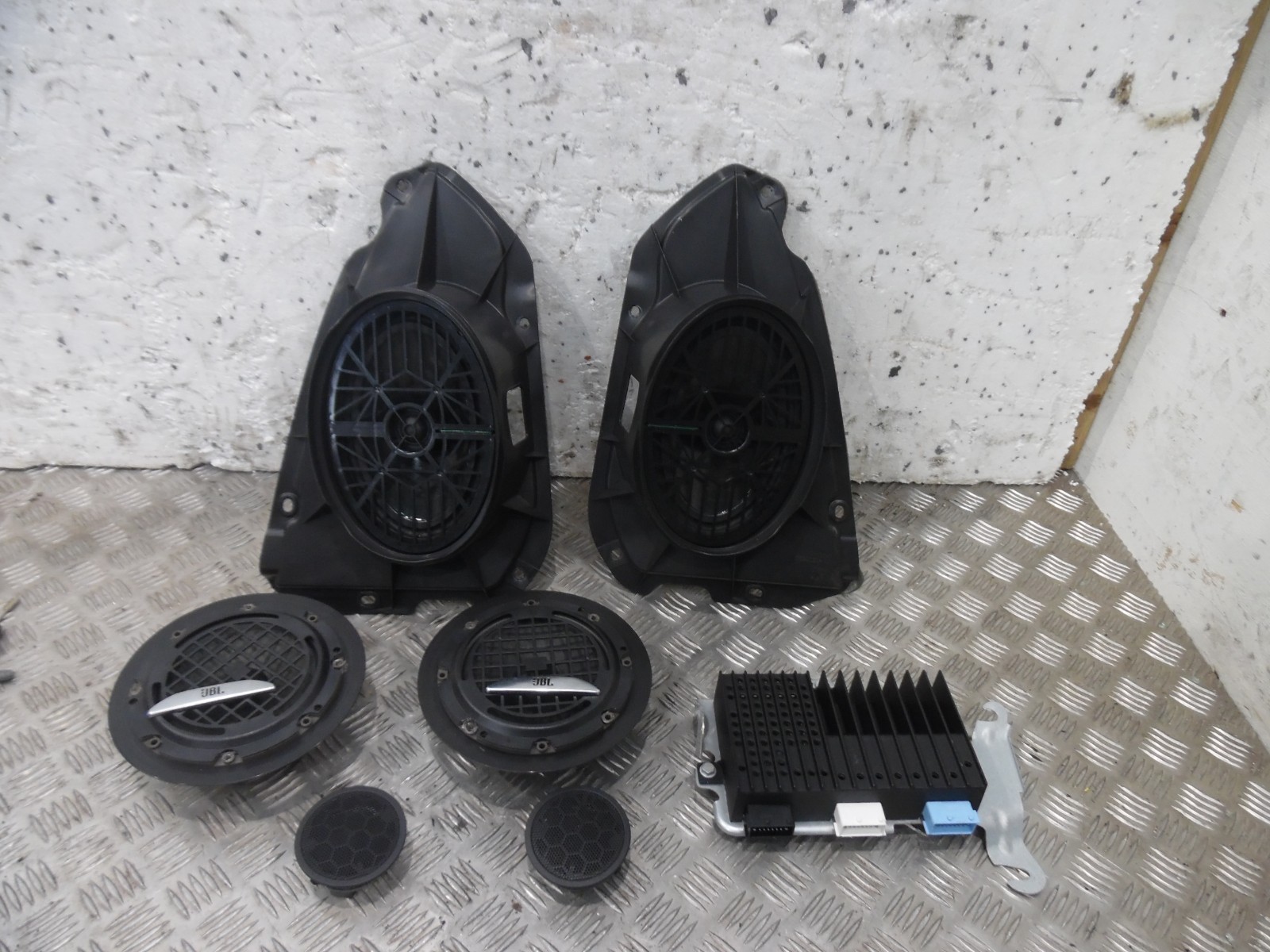

Considering upgrading the standard sound system to the JBL option.
Can anyone confirm that all the required components are included in this pic?
I'm guessing this is compatible with the standard (non sat nav) head unit? Is it just plug and play?
That's obviously the power amplifier where in the car is that located?
What's the power of the oval speakers 25w ?
I'm curious because that's the power on one in the scrapyard which has the JBL system in.
Just a thought, if you are changing the unit, you might want to get one with dab, I thought this was standard on JBL systems and my JBL system doesn't have dab.
Sorry I can't tell you if you need anything additional.

I literally swapped the rear speakers three weeks ago. I used this guide on the forum which guided me through the process http://www.peugeotrczforum.co.uk/viewtopic.php?f=20&t=10771
I only changed the rear speakers to the JBL Car GTO 939, in my opinion the two front speakers who are producing high and medium frequencies are good enough. Please be warned, Peugeot did an excellent job at making the rear speakers as inaccessible as possible, changing them will take you 3-5h.
The rear speakers are connected by two small wires (standard red/black) but the connector is custom made by Peugeot and not reusable. I had to cut the wires and solder a new connector along with a cable extension to it. Furthermore, the plastic casing that holds the rear speakers in place is also custom and will most likely not fit your speakers. I had to cut the plastic casing deeper into the room behind the speakers (where the rear tire is), and screw the speakers onto a wooden ring which I then attached to the plastic case.
It looks like you have everything, two oval big speakers for the back, two medium speakers for the doors and two small speakers for the dashboard.
I don't have confirmation on this but the amplifier in the stock radio should do 25 watts on 2-4 ohm. The rear speaker I can confirm are 25w and made out of cardboard. The factory speaker are not bad, but they are also not good. I highly recommend changing the speakers, it makes a big difference.

The JBL parts in the pic are from an RCZ so my thinking is it should be plug and play.
Just need to know if any additional parts/looms are required.

Again, I can only talk for the rear speakers but I would be very surprised if the other speakers are different.
It's not consumer friendly 'plug and play' where you remove a connector from the old speakers and connect the new speakers.
This means you need soldering iron. I also recommend some spare wires, the stock wires are not long enough. Alternatively , if you have them, you can use a cable connector, that's a little plastic device that holds two wires together. Here an example https://cdn.shopify.com/s/files/1/1403/5817/products/Phoenix_only.jpg?v=1512763644
Apart from that, yes you can consider it plug and play if you connect the wires. Radio on and it should play.
1,297
I very much doubt getting the amp to play ball without the requisite loom will be much fun.
Which from memory of pulling my RCZ apart to fix rattles lives somewhere around the rear lights. Which side I don't remember.
