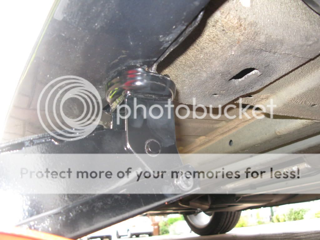

I found a picture of the back one in this thread:http://peugeotrczforum.co.uk/viewtopic.php?f=28&t=881&start=100
(it seems you should place the jack "in the front" of these wider ones???)
Yes the back ones are about 4" long. The jack pictured appears to me to not actually be using the jacking point at all and appears to me to be too far forward! I have just received my newly purchased jack and intend having a cylindrical piece of metal bored out so that it sits secularly onto the trolley jack and the other end with a slot cut out to allow the cars jacking points to sit within it and be unable to slip off. But the closeness of the side skirt terrifies me!!!

And judging from the placement of the jack in the manual, the support should go all the way to the car side?
Dunno... :roll:

Awful experience you've must have had... Well finally we did it!
It took 2 hours (1 hour to figure out how to do it)
As far as wee could see there are no weight support at all outside the "metal pieces"
We used a flat "rubber puck" on the jack which we put straight under these metal pieces sticking out.
(Not ideal, the rubber almost split in two after the last lift) some kind of metal construction would be much better.
Actually looking at "kentdriver:s" lift again, this is what he also did, I see now that the image must show the lifting of the right front tyre... and his jack is "holding" around the "metal piece" *phew* I was nervous!!!
