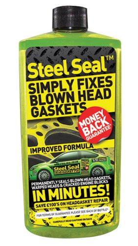

Apart from the sensor issues I had with the GT200, I have not problem with head gasket, saw this stuff and maybe worth a try to you guys who have the leaking h/gasket?
maybe save a few quid - does say money back guarantee ?
3,217
NO!!! Don’t put that stuff in whatever you do :helpme: that’s a last resort measure for blown Head gaskets not for weeping rocker cover gaskets :crazy:
And to be honest I doubt if it would seal a blown head gasket! These products prey on skint punters who are faced with huge repair bills and resort to a not so cheap miracle fix I know I’ve been there :cry:
I second this. Don't use that crap unless you want to completely screw your engine. :eek:
So that would be your £4.60 back. Should help towards the £1600 engine repair bill :eusa-think: :wtf:
5,099
568
I think that stuff is a bit like the old “Radseal” for leaking radiators.
Yes, it stopped the radiator leak (sometimes) but it also stopped water flowing through thermostats, small bore coolant pipes, everything really.
Quick fix ? You decide :eusa-think:

Wow - screwed that one !! :thumbdown:
I thought that stuff was a gasket type sealer, not a liquid additive.
I would never put that stuff in my car for all the things you guys say.
I just saw it whilst I was looking for something else, didn't read the how and what have yous.
