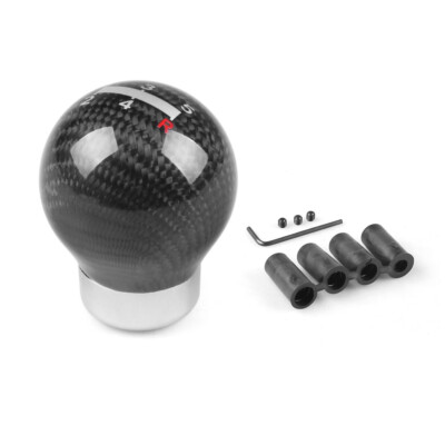

Hi all, The leather has come off my gear knob, I brought a new one from Amazon but the push fitting on the new knob is to small.
The old one pulled off with a bit of a struggle but now need to locate and purchase a new one.
Does anyone know the size I need, and where to buy one.
Regards Dave.

Good morning all.
Verminator, asked for some photos of the gear leaver and gear knob.
I need to buy a new gear knob I have tried E-Bay/Amazon but they do not fit.
any advice where to buy one would be great.
Regards Dave

Morning Verninator ,Does the blue bit unscrew, its tight and i don't want to force it if it doesn't.
1,874
903

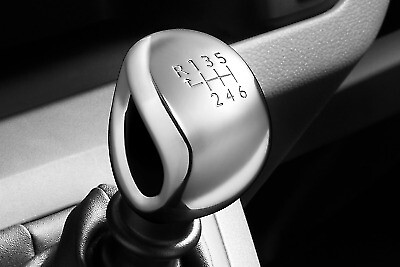

No that stays in and the new gear knobs that fit the peougeot just slot on to it if you have got one like this it will not fit right 😩...
