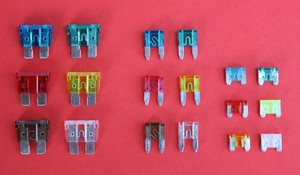

Ok, so really showing my automotive ignorance here. I am wanting to buy a piggyback fuse holder to hardwire my new dashcam.
There are several sizes available to order, micro, mini and standard.
Can someone tell me what size fuses there are in the dashboard fuse box ? I don't want to order the wrong size, and having looked in the fuse box I am no wiser, except I can see that the ones running horizontally are smaller than the few stacked vertically.
I assume the vertical ones on the right are "standard" size, so I just need to know if the ones running horizontally are "micro" or "mini" size.
I tried looking it up in Google but no joy there.
Thanks

Standard Mini Micro Blade Fuses

Just for anyone's information for the future:-
The smaller fuses that run across the under dash fuse box are MINI size fuses.
The Larger fuses than run vertically down the right of the under dash fuse box are REGULAR or STANDARD size fuses.
