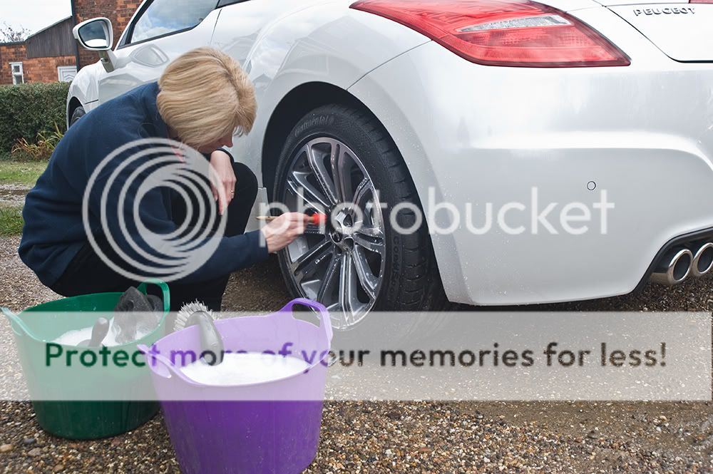

Started with the wheels as usual.
First they were power-washed down.
Then using my 2 bucket method - green containing water and shampoo (Chemical Guys Wash and Gloss),
purple for rinsing, the alloys were cleaned using a variety of wheel brushes for spokes, rear of wheels, wheel arches, tyres, etc
Once all 4 wheels cleaned - power washed down

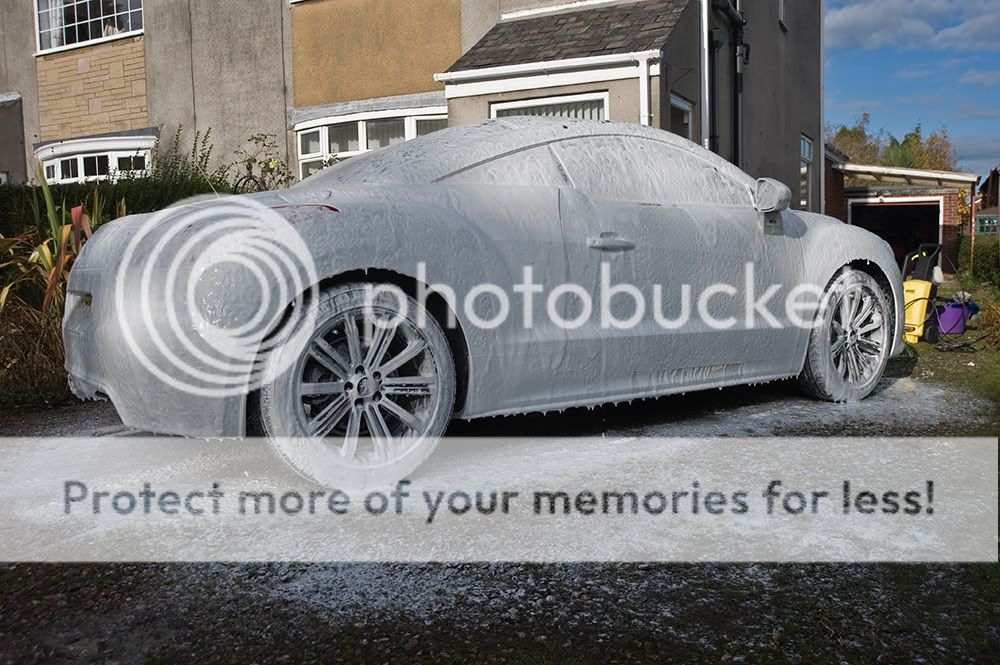

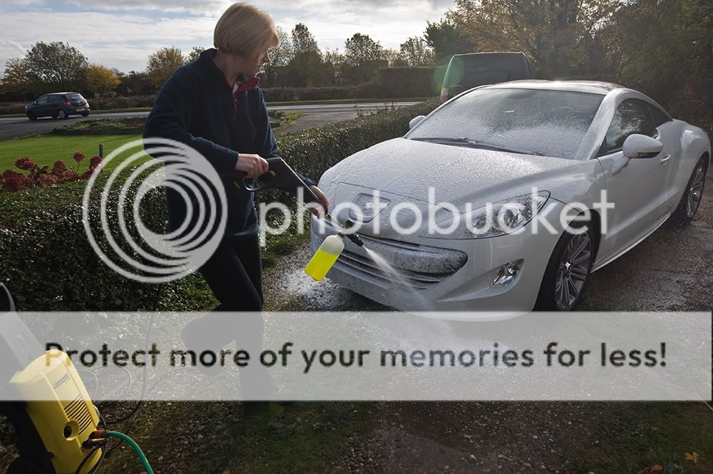

Next onto the snowfoam.
1 inch of snowfoam put into the foam bottle, topped with a couple of drops of shampoo (same as above)
then topped with luke warm water.
Attached to power washer and the fun begins ..... !
The thicker the snow foam the better it works, I've found. It looks almost like shaving foam.
Here's some pics

After 5 mins, the snowfoam is rinsed off with the power washer, making sure all suds are removed.

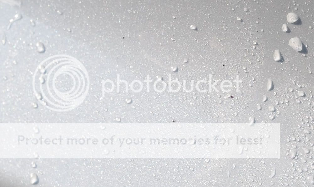

This is a new product to me but one I felt that I needed to try especially on a new car and because its white. Iron X is used to drag out any contaminants / iron filings /etc that a car picks up but are very hard to see with the naked eye. If left, they end up rusting into the paintwork, causing problems later on. Claying will not remove them. This just takes the top of them, but the rest is left inbedded in the paintwork.
So you spray Iron X onto the paintwork, wait 2-3 minutes and then wait for it to turn red - purple. The spots you see below are the iron filings which have turned colour but were naked to the eye before the Iron X was applied. These are wiped with a cloth and then the paintwork rinsed. This was done all around the car. In actual fact there wasn't much - probably due to the fact that the RCZ hadn't been sat around for months on end in a compound or next to a railway line.
Spraying on:
Iron filing / contaminants
After the Iron X, I planned to clay, but because the Iron X found so little contamination and after running my fingers over the paintwork, it already felt very smooth, so I decided that claying wasn't necessary this time. Probably a job for next Spring.

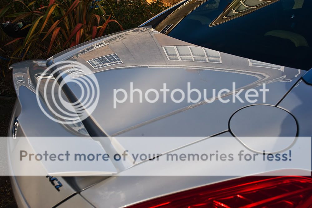

Finished shots :
People often say that its difficult to capture reflections on white cars but I think you'll see, we have a few here :thumbup:
