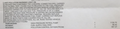

Please see the first report from Peugeot. Now the same problem has occurred.

If your using a dealer I would get the car scanned at a indie garage & post up the codes from the cars ECU as this makes no sense original fault looked like the Engine was running too rich hence the depollution fault but one aspect of failing fuel pump/rail/Lambda sensor or sensors as there are 2 on the car (oxygen probes) is the car won't idle properly it will start to judder on acceleration & have a high fuel consumption if you are experiencing any of these then ruling out the HPFP again it could possibly be the low pressure pump in the tank assuming they haven't checked that option yet ?

Oh these are the codes on the invoice. I don't know what they are on the car. I was just told this.
I believe they are Part Nos as pe9819938480 is the HPFP the others are more likely the fuel rail & Lambda sensor
