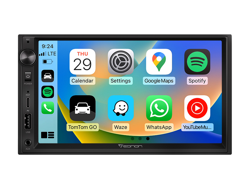

Hi all,
Bought mine yesterday, and it's developed a fault already. So sad...
Anyway will need to upgrade the ICE to run Android Auto now that I've done the same to my BMW F31.
I know I will need a fascia replacement, some sort of adaptor to utilise the stalk control, and a double DIN stereo. Any recommendations please?

Haven’t tried any other brands but I have an Xtron unit fitted, been in well over a year and no issues once I got it fully setup.
i did have to purchase a different canbus decoder than was supplied.
also found xtron staff helpful when setting up and looking some info

Thanks EddieJ.
That looks like the ones they sell on AliExpress. From what I can see the unit sticks out a little bit rather than flush to the rest of the console. Is that correct?
I'm now almost ready to get a Linux one instead.
I have a linux one in my BMW, and works out just fine as prefer to use Andriod Auto and don't want/need to install any apps onto the unit. The only thing is the screen is smaller than yours, and I need (and have bought) a fascia kit.

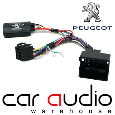

Did mine tonight.
The fascia sits flush and is the same piano black as the rest of the trim. The head unit is recessed into the slot but looks normal. Also managed to upload the Peugeot badge as startup logo so now it looks pretty OEM.
Only thing of note, for those looking to get this, is that you need the adaptor for the aerial. Dual Fakra to DIN to be exact. That way you can utilise both aerial cable into 1 DIN plug. The Connect2 CANBUS adaptor also works well. Press Next and Prev button simultaneously and the menu comes back up on the orange screen. The X3 also allows programming of the steering control for different functions.

For £54, you can access the menu on the orange screen without putting the old stereo back in.
Thanks for that might come in handy.
Am thinking more about the flush unit for the other car which may lead me to need the adaptor.
My stalk controls all work to volume up/down call end call etc just can’t get to menu on the lcd display, though haven’t really tried looking into it as yet.
