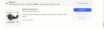

I fitted this a few weeks ago off ebay Mine is the 200 you remove the bleed screw to insert the temp sensor probe wiring harness very easy job as Kam says Thermo tank.PNG
