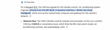

Very strange when you bought the replacement did it come with new connection tails ?
