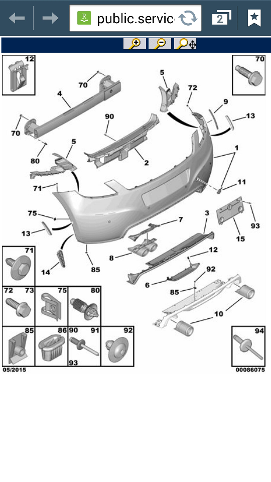

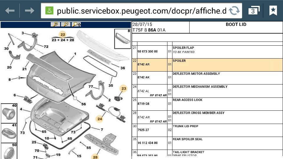

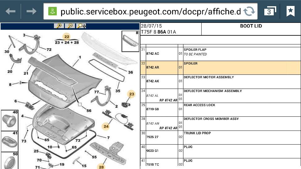

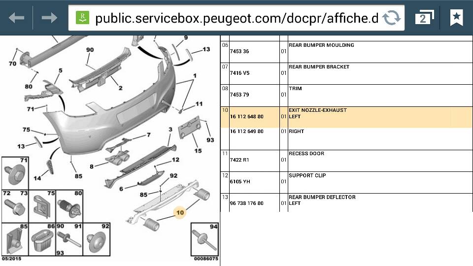

This is for the exhaust trims but you will also need crossover pipe, valance etc.
Spoiler is the one greyed out at top right.
It's fixed and it's based on my vin for my RCZ-R.
This one is for the standard RCZ
