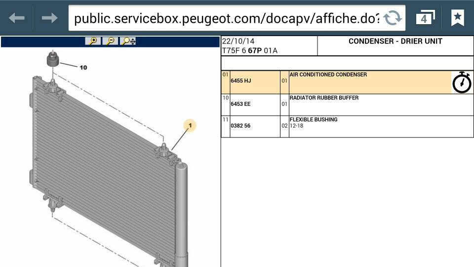

Anyone got a part number for a 2011 2.0hdi air conditioning radiator? Mine has a hole in it and the stealer wants criminal money for a new one!!!!
Is this what you after?
This is listed as an rcz hdi. So I think it's the same for all years.
Yes that's the one! Thanks Tianorth. I've managed to source one from UK for one third of the price that the Cowboys were charging me here!!!
Are you sure that it's the same part?
Some brands have been saving on the material used for the "mesh" and the cheaper ones are very brittle so you're more likely to get a leak.
Does it say what material it uses?
:thumbdown: Yikes, now you have me worried. I'm not even sure if this is a genuine part. It still hasn't arrived yet. fingers crossed its a good one!
