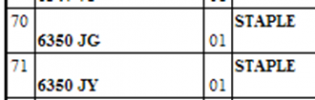

The clips / tabs holding the cover in place don't look too expensive, available from a Pug dealer....
View attachment 14015View attachment 14016View attachment 14017
I didn't think to look if the clips and tabs were separate. Dealer it is then for the parts. I'm pretty sure I could fit it myself, but I will probably look for a volunteer amongst my children or grandchildren - getting old has to have some perks!
