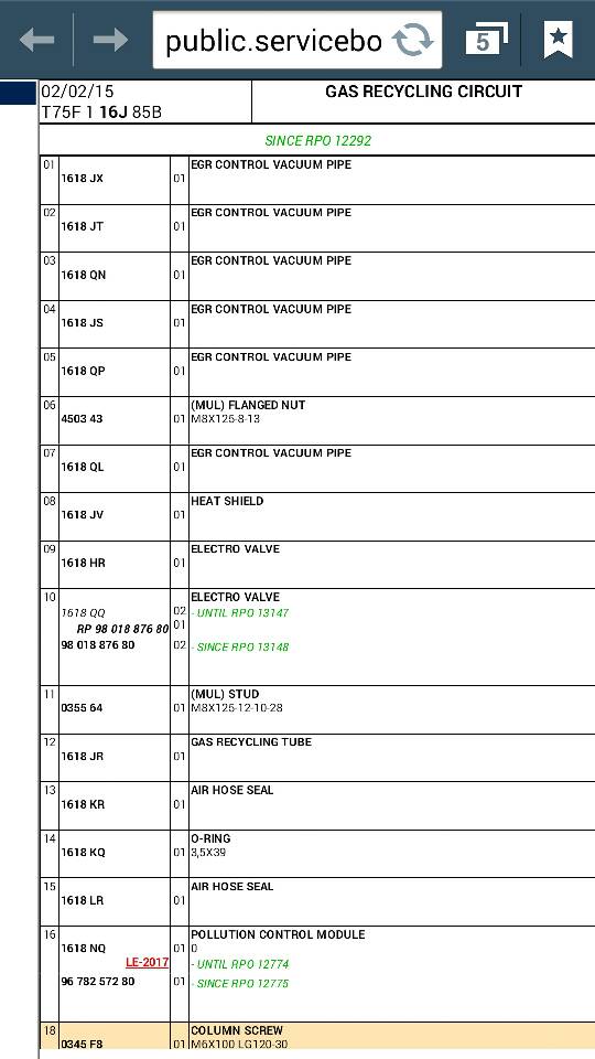

If it's anything like the 407 and 508 it will be at the back of the engine. Is there a silver pipe that runs front to back?
Attached at the intake manifold at the front.
Hi no it's not the same it doesn't have any long silver pipe going across anything I don't know where I saw it but I saw someone clean their EGR themselves on a rcz and they were talking about it was at the front of the engine I haven't even got a clue what it looks like got to be someone out there who's had this problem I do get a small misfire around the 2000 RPM but that's the only code I'm getting
1,297
It must be part of the inlet manifold?

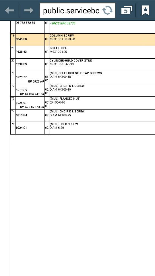

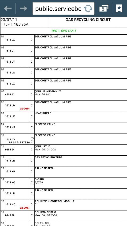

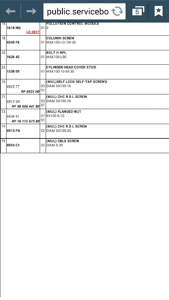

A few bits that might help
