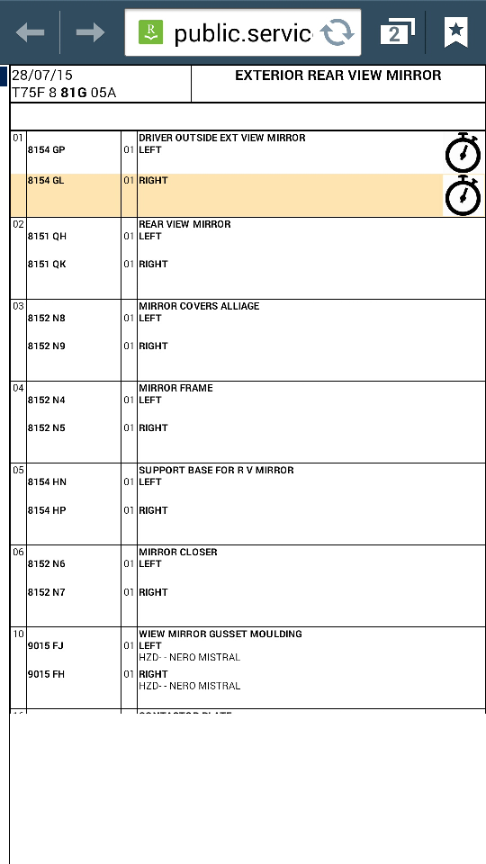

Any idea what one I need,I think I need the memory ones as I can set the wing mirrors for when reversing.
GT200THP 60reg asked on Facebook group and its £400 new [FACE SCREAMING IN FEAR]
52

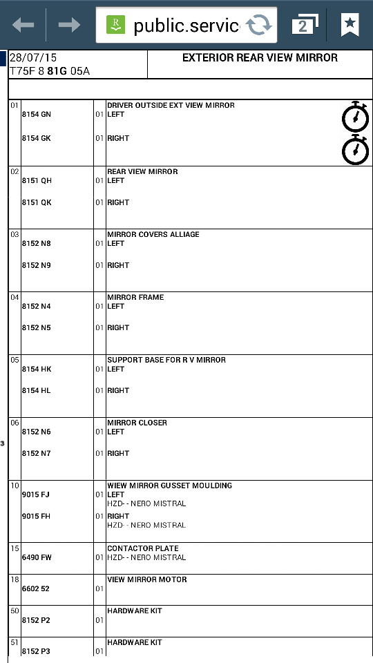

Send me a pm with your Vin number and I will see what the part number is, I'll also see what a mirror from a non memory one is.
Thank you so much,I'll find the vin number and send you a message,I'm thinking of going down the second hand route as the memory one is £355

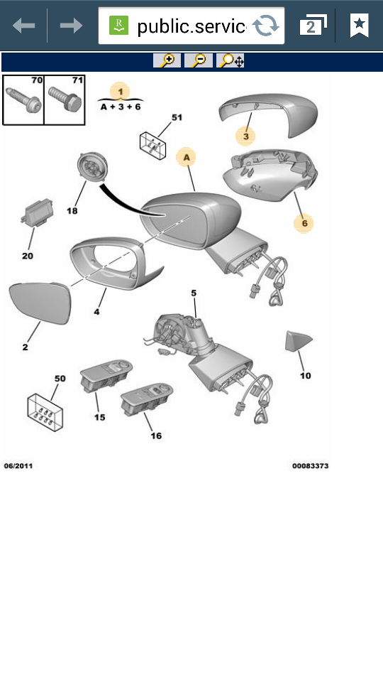

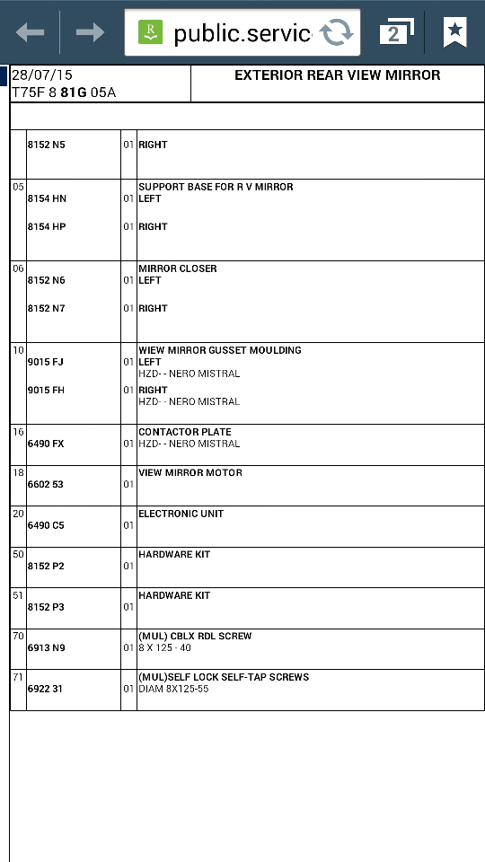

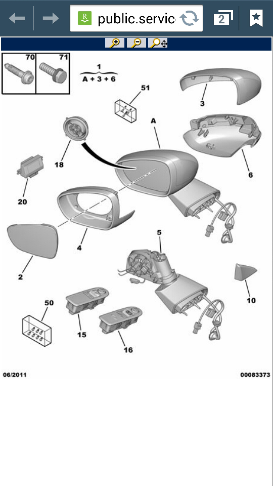

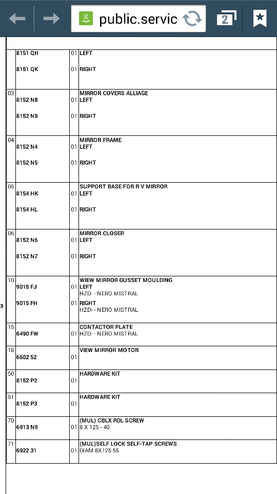

52
Here is the mirrors with your Vin number.
It's only the base that I need but knowing Peugeot this comes as one,I've spotted one in a breakers yard but still comes in at £150 plus vat and will need to be sprayed as it's the wrong colour,I think I can salvage the mirror plastic just the base would be wrong colour as that part doesn't look like it comes off.
Any idea how to remove the wing mirror ?(doesn't look the same as the 207 so all the screws must be located when door trim is removed. )
52
Can't you see how much the bits are from Peugeot dealership?
Since you know the part numbers!
To remove, there is a triangular piece (number 10 I think) in the inside window which would cover the holding bolts (I presume)

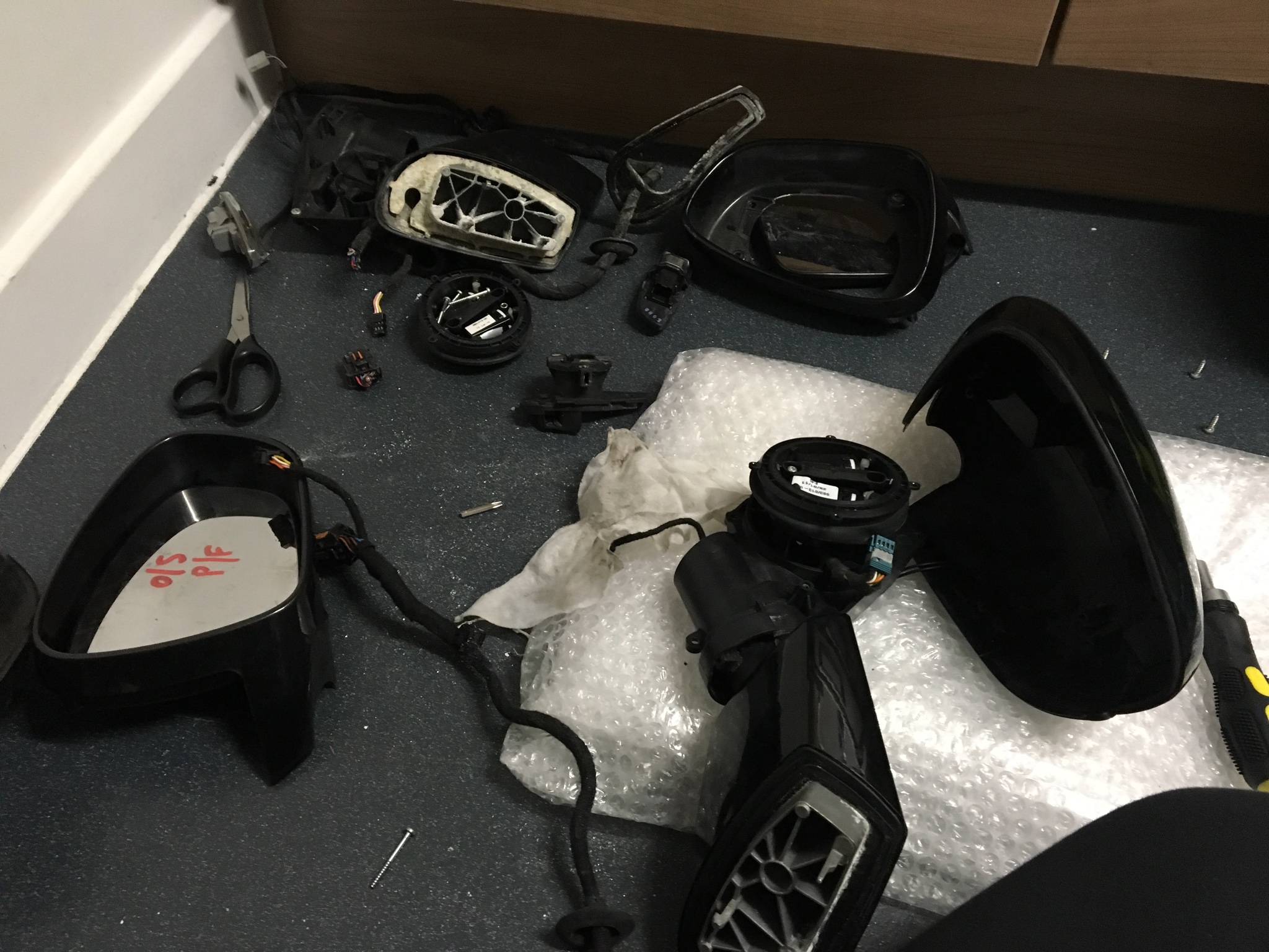

So after the epic job of swapping parts over from my old wing mirror on to the new one due to parts being wrong colour I managed to get them working and attached to the car now the only problem is the window won't go down more than half way,I think the wires from the wing mirror that lead into the door are getting caught but don't fancy taking it all apart again.
Any idea of what it may be getting stuck on or how the wires need to be placed,here's what my Saturday looked like ...

I have great news,after fixing my wing mirror someone's knocked the other side out of place and I've got the same issue with the other wing mirror now.
So upset!!I'm going to have to take the other side apart and see if it can be fixed because it's getting beyond funny now.
Surely it's just a spring being knocked out of place?When I took the other one apart there is a big Spring inside the motor but couldn't see what was broken for them to not sit in place.
Here's to another fun weekend fml.
