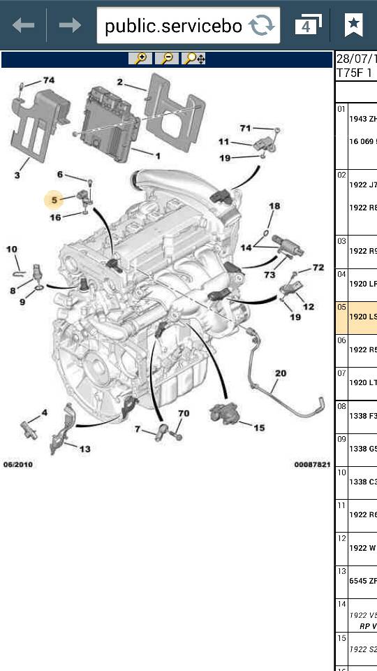

This is for a 156 engine.
Didn't know what engine you have.
