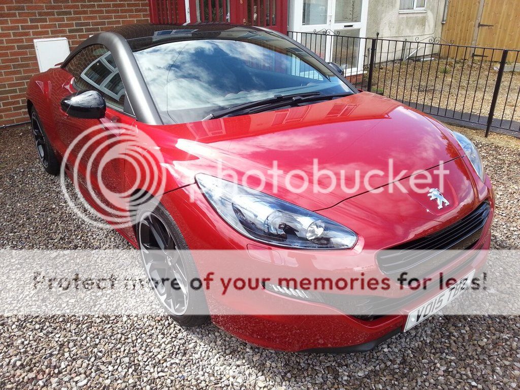

RCZ with R222 Wax, goes on easy comes off easy so no complaints with regard to application does not smell as nice a Souveran.

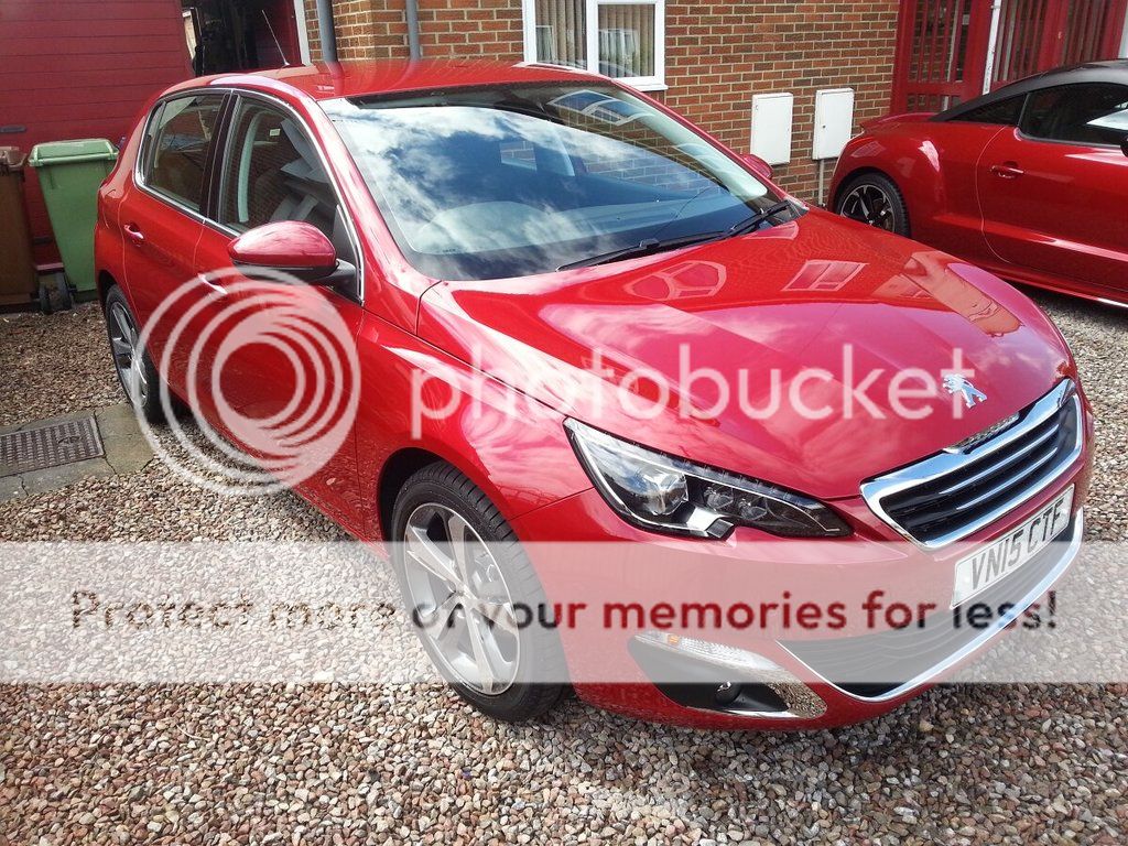

308 with Souveran, goes on easy comes off easy could not really say that there is a difference with the R222 in that respect. However it smells wonderful not sure if that is a major plus or not.
In terms of finish both buffed up really easily and with next to no effort. It is hard to see in the photo's and the colour is slightly different between the two cars but I think the Souveran had the edge over R222 for depth once buffed out.

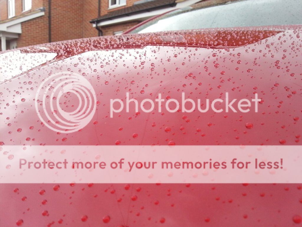

As luck would have it :thumbdown: we had a storm after finishing the buffing so I had a chance to assess the beading of the wax's.
RCZ - R222
308 - Souveran
I think the water stands up slightly more on the Souveran than on the R222 but it is a close thing, the plan is to snow foam / wash the cars weekly and assess the beading on the wax's to see which one stands up better over time I will post subsequent updates to this thread.
